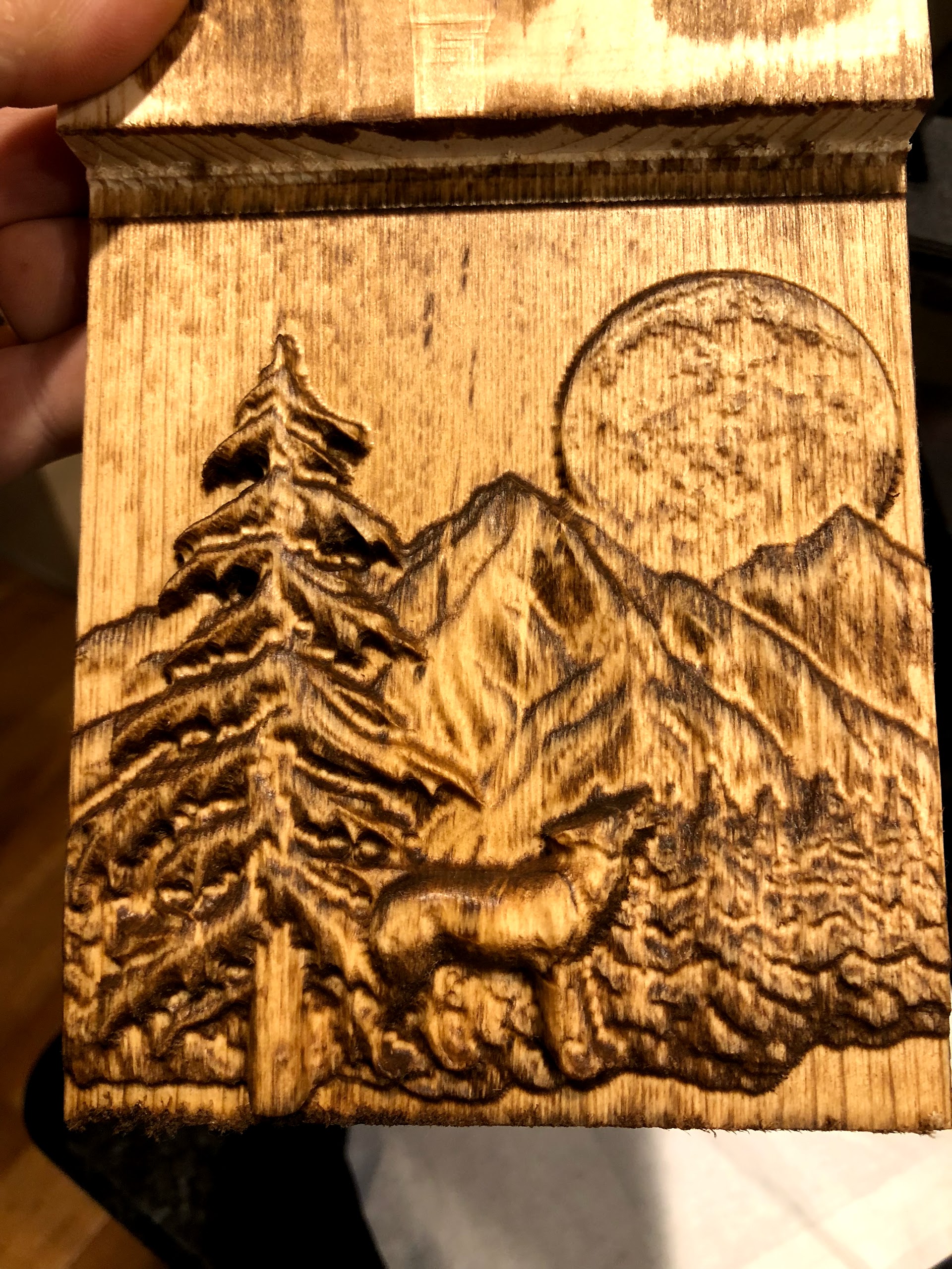

First carve went pretty good. Any suggestions will be appreciated since this is definitely a learning process.
Like pretty good, what type of wood, bits, speeds did you use?
Also, is that a stain you used for finishing?
It is just pine, I used .25 end mill, .125 ball nose for finish at 500mm/min @23000 rpm. Yes it is just a wood stain.
Very nice!
Great job Jamie!! Looks amazing for a first carve!
