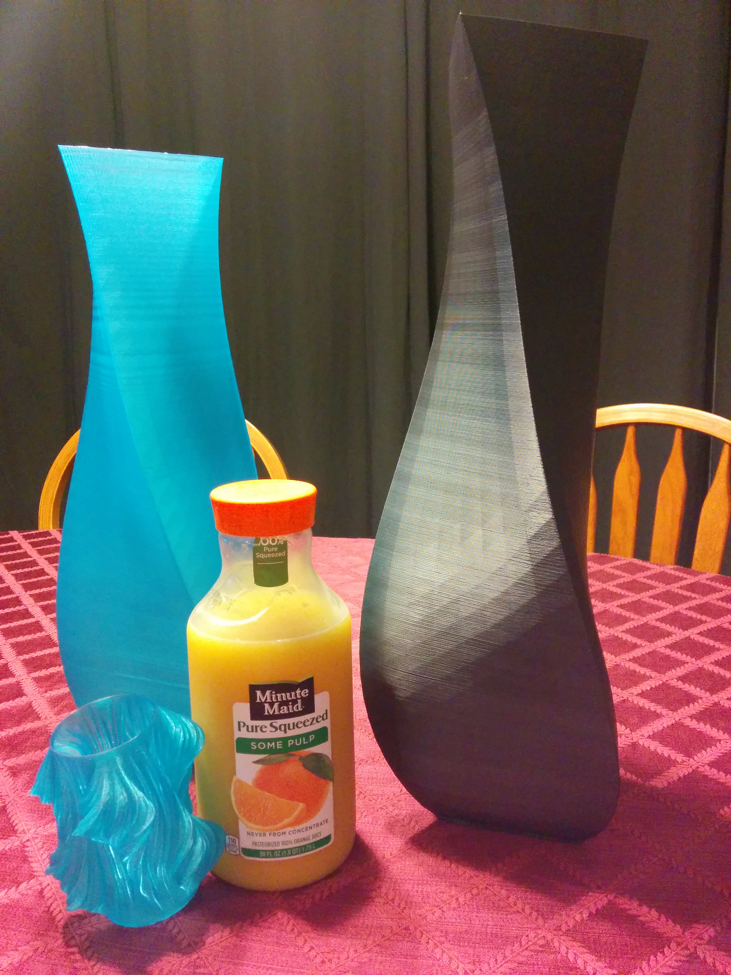

First day of test prints from the short bowden floating extruder setup
exceptional surface quality!
Thanks! The aquamarine was .2mm layer and the black pearl was .4mm layer height. I had issues with the black pearl (some kind of powdery residue) on my smaller nozzle, but it goes through the larger nozzle reasonably well.
Incredible!! What printer are you using??
It’s a delta that I’ve “winged” Here’s some of the initial build photos

I designed the new extruder system from what I liked about Steve Graber’s gigante.
https://lh4.googleusercontent.com/-19ZHS3tc_H8/VKQyN9SAV8I/AAAAAAAAVic/QZqbzR4jFb0/w745-h993-no/IMG_20141231_122819.jpg
I made it lighter and ended up using some thicker surgical tube.
The design is here http://www.thingiverse.com/thing:615563 for that.
