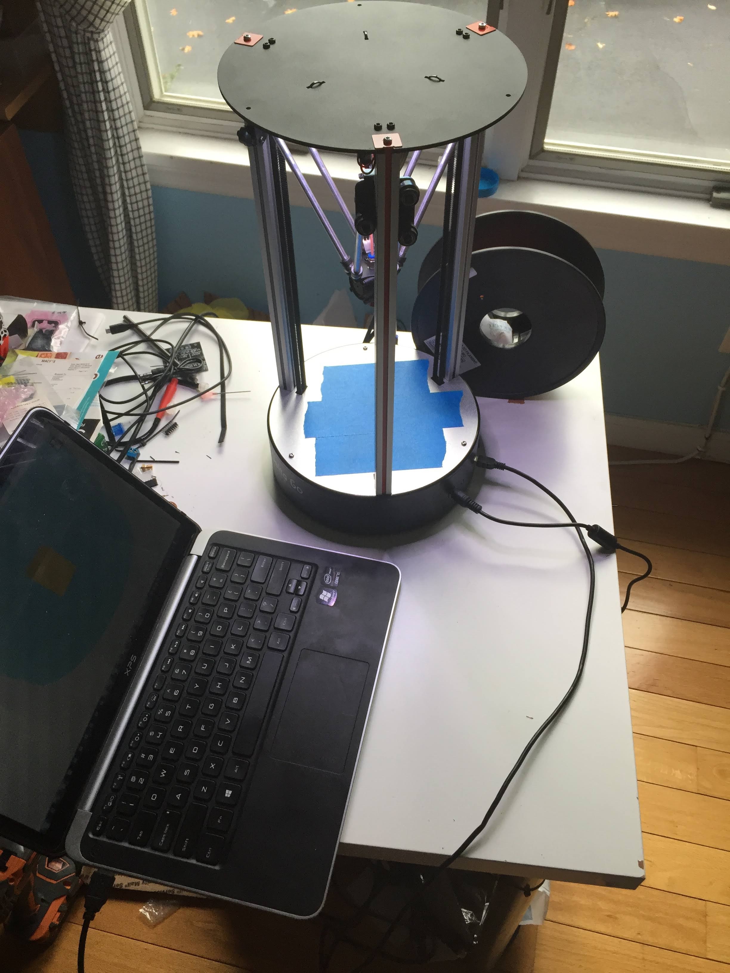

First day with Deltaprintr Go.
Originally shared by Ray Kholodovsky (Cohesion3D)
Get a new toy in this morning. After probing and printing a test cube, I did an Aria dragon (of course). That was in their provided orange PLA and cura settings - namely 30mm/sec speed and 1mm retraction. You can see how that turned out. I bumped up the speed to 70mm/sec but the nozzle got caught on a warped up top layer of the print and one of the arms disconnected - this happened twice in the same spot, same gcode. Anyways, I backed down to 60mm/sec and 6mm retraction and you can see the results in the green inland PLA print there.
Tech support was very quick to respond via chat. Nice work @Shai_Schechter and the Deltaprintr team!
Aria dragon by @Louise_Driggers , some fire breathing rights reserved.
@raykholo ah, retraction, one of the most important and overlooked settings… That’s some fairly impressive stringing on the orange one!
