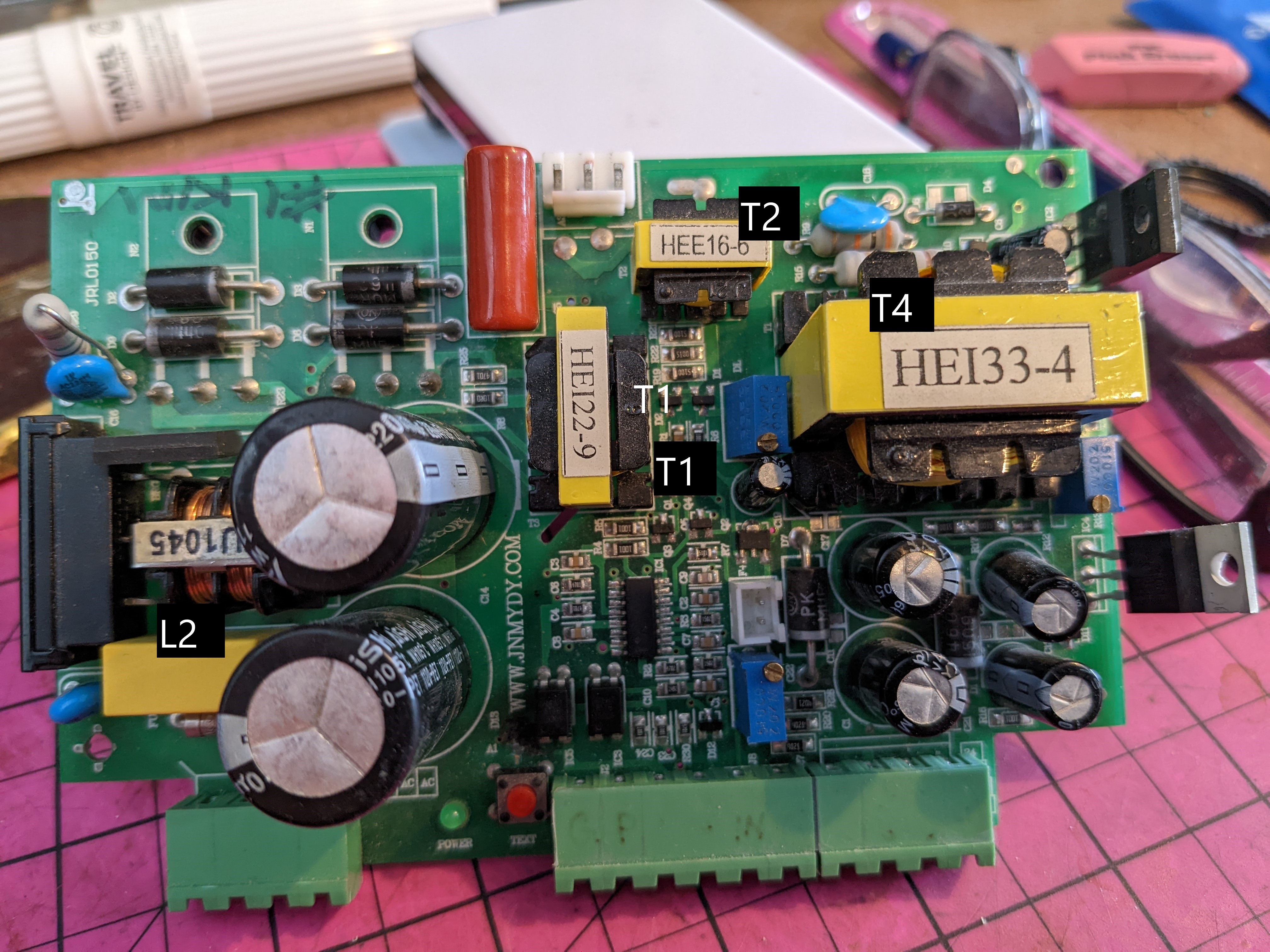

First draft of the power supply. Have not annotated the parts yet

I am ready to construct this power supply, At this stage I want to identify parts.
like:
  1. What is FLM (L2)? What is it part number to buy it from market?
  2. Current sense transformer T2 is UU1045. Am I right?
  3. PWM T1 Transformer. What is it part number to buy it from market?

I will check again but my supplies do not have part # for the transformers.
If you don’t have one, get a LPS and scavenge the transformer parts that way. You can buy a new one or get a dead one, there are lots of broken ones sitting in maker sheds.
Here is what I found. I updated the schematic with these #'s.
I did not try these parts # to see if I could find the manufacturers.
If you find them please let me know.
Note I do not know if all vintages of these supplies have the same xformers.
