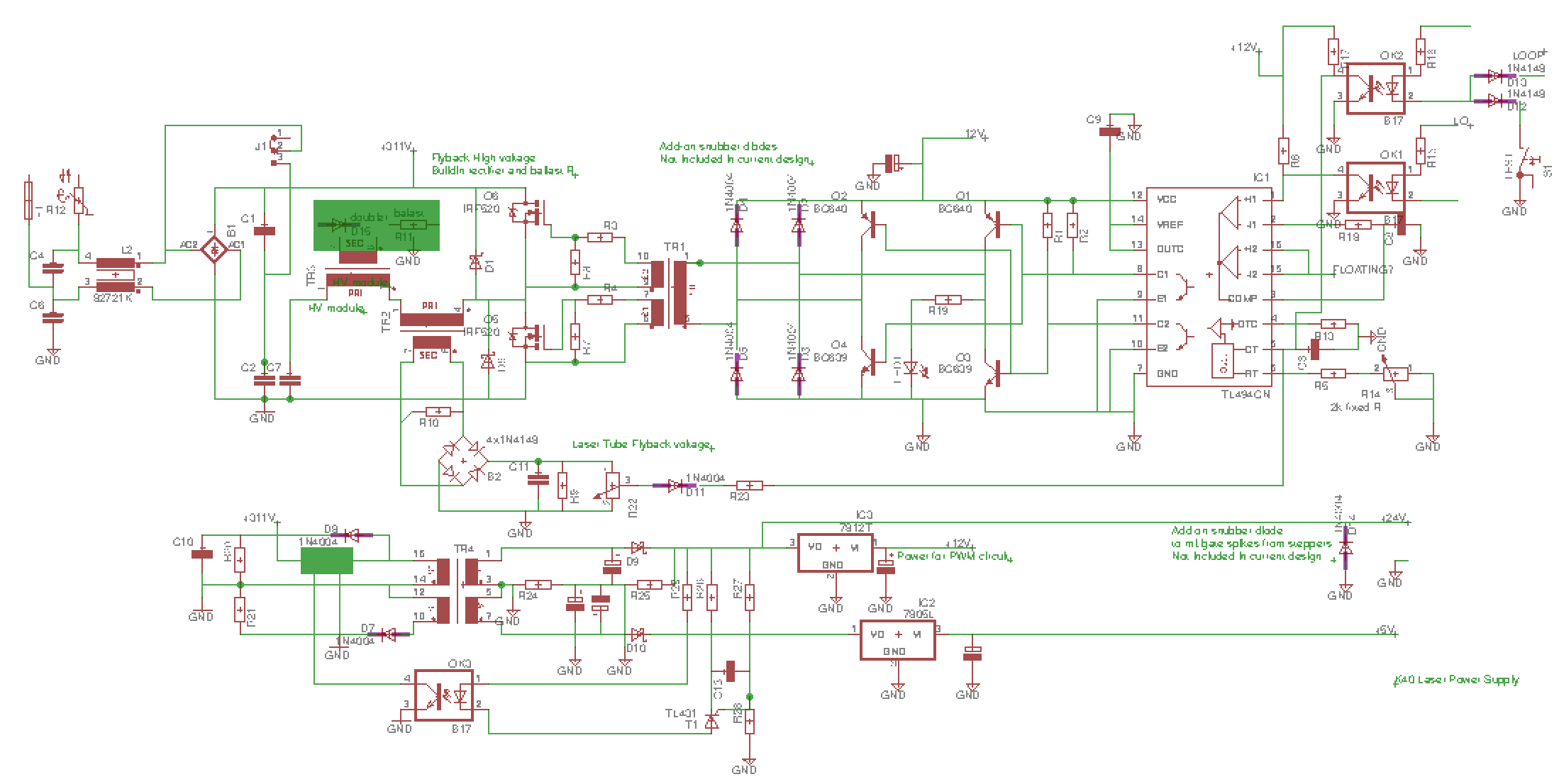

First draft of the power supply. Have not annotated the parts yet
First draft ofcthe power supply. Have not annotated the parts yet. Hopefully get that done this weekend. The snubber diodes were added by me since a transistor shortened and the rectifier diode in the 24volt supply. As you see grounds between 220/110 and low power gnd are separated but can fail if a capacitor fails. Hope this helps everyone.

Awesome, this is just what we needed, thanks for doing this. What tool did you create this in and can we get the source as this picture is a bit hard to read?
Also on the next version if you can clarify where the control signals enter the supply that would help me verify the external control schema. Its also difficult for me to find the AC input. Hard to read when I blow it up…

@donkjr i used eaglecad which is free. And of course i will publish the schematic in its full form. I knew some people were after this so i publish this first one asap.
@donkjr yes a bit of a narrative is required to explain the functions. The reversed logic of firing the laser with 0 can be easily fixed as well. Keep you all posted.

Which diodes are you referring to? I still have difficulty viewing the schematic as it is blurry when zoomed.

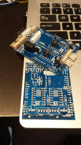

@donkjr it’s the rectifying diode in the 24volt supply line. I have a nanom2 and a grbl cncshield with a arduino. Also have made my own to get playing with it. I think that indeed there were some ground issues. Haven’t assembled it all together yet since i still have annotate the schema.
Still a work in progress to replace my cnc shield so i can just plug in all my connectors. Just waiting for the headers to arrive
