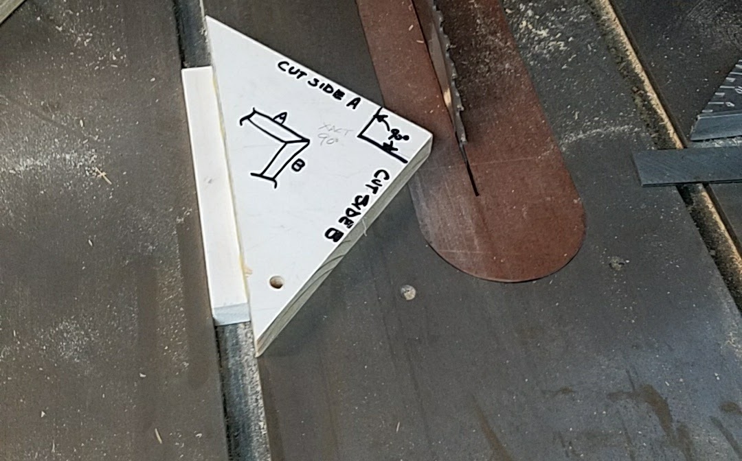

In case you didn’t know this trick for cutting perfect 45 angles.
A & B are opposite sides of the 45
Oh that a nice jig idea.

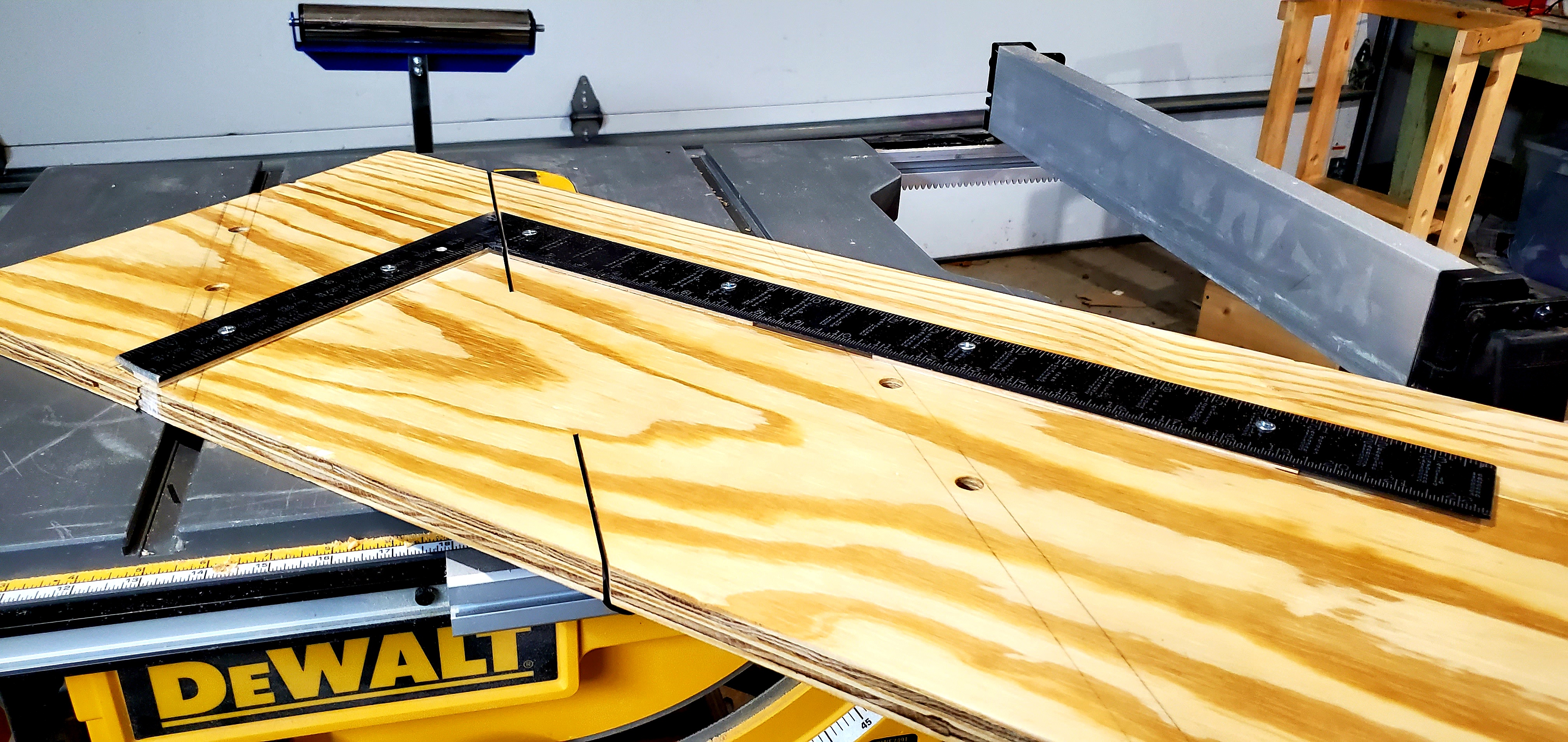

This is my framing jig. Since I took the photo, I have added a stop block with a 45° and a toggle clamp to the long axis. Cut on short axis, align stop block with measurement on long axis, engage toggle clamp, marry the 45°s and cut.
Always many ways to accomplish the same thing …
