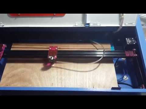

First fire of my modified #UK40OB Smoothie powered, LaserWeb enabled
Originally shared by Ariel Yahni (UniKpty)
The #UK40OB its ALIVEEEE!!!

This makes me want to get a second K40 just to do stuff like this to it. I can’t do that to the one I am currently using because, well, it’s a (semi) production machine. I can’t have it dead while playing.
@Ashley_M_Kirchner_No I know what you mean. I had everything planned and then changed almost everything
Such is the nature of DIY projects though. Rarely do I end up with something that’s exactly as planned. But I’ve been wanting a larger cutting surface so this may warrant a second cheapo K40 just for fun.
I wonder, in your build, you attach the side rails directly to the chassis. Considering how thin that metal is, are you concerned with it twisting out of true level if you move the machine?
That can be an issue but Is a gamble between that and the bottom of the machine that was actually allready out of level and wobbly. It was a judgment call
True, but I think if you had build the gantry on a solid plate and laid that in the machine, regardless of the bottom of the machine warping, that plate would always be flat and the gantry would always be level in comparison to that plate. If the plate is at an angle, so would the gantry sides and the laser distance will always remain the same regardless. As long as it’s lined up with the rear mirror, you should be okay … Then again, you can always just build your own enclosure and chuck the cheapie Chinese one.
