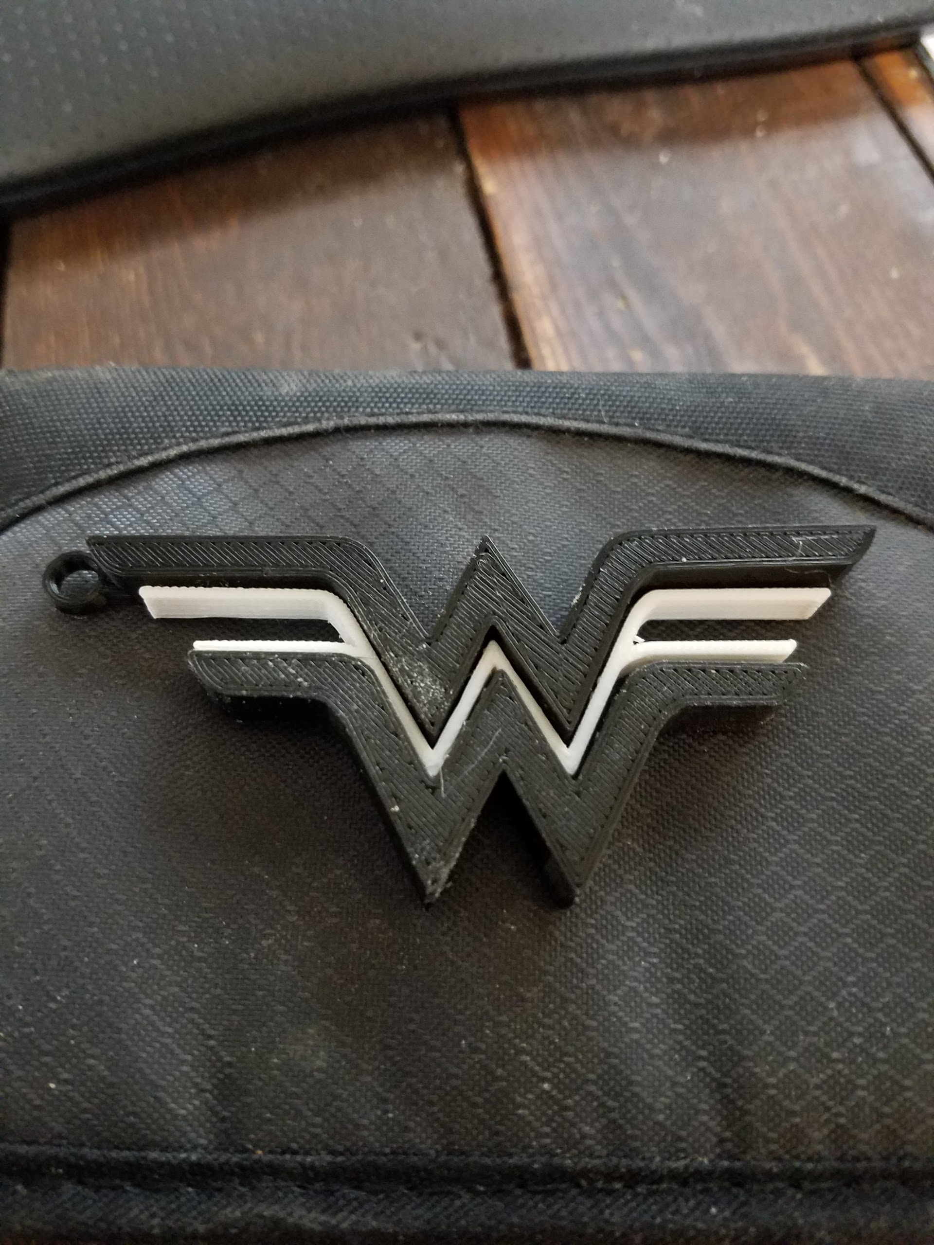

First good print in white.
First good print in white. Had to use Cura because other slicers would infill correctly.
Infill “correctly” or incorrectly?
I thought infill was correct. My problem was the top and bottom layers weren’t solid. It’s the same settings I’ve used for other prints. I tried taking it to 100% but still nothing. In Cura it didn’t seem to have a problem. This is the first time I’ve printed something this thin so I had to slow it down and couldn’t get that right in Slic3r but Simplify3D did well but the top and bottom layer thing. I’ve currently got another printing to test some brim settings before I print multiples.
Incorrectly. Got ahead of myself.
OK so Cura worked as you would expect, but other slicers did not ? (“because other slicers would infill correctly”) Sounds like you’re saying Cura only worked because it does infill “incorrectly”. Confused.
Ah ok :grin:
It looks underextruded. The surface should be solid and no gaps.
