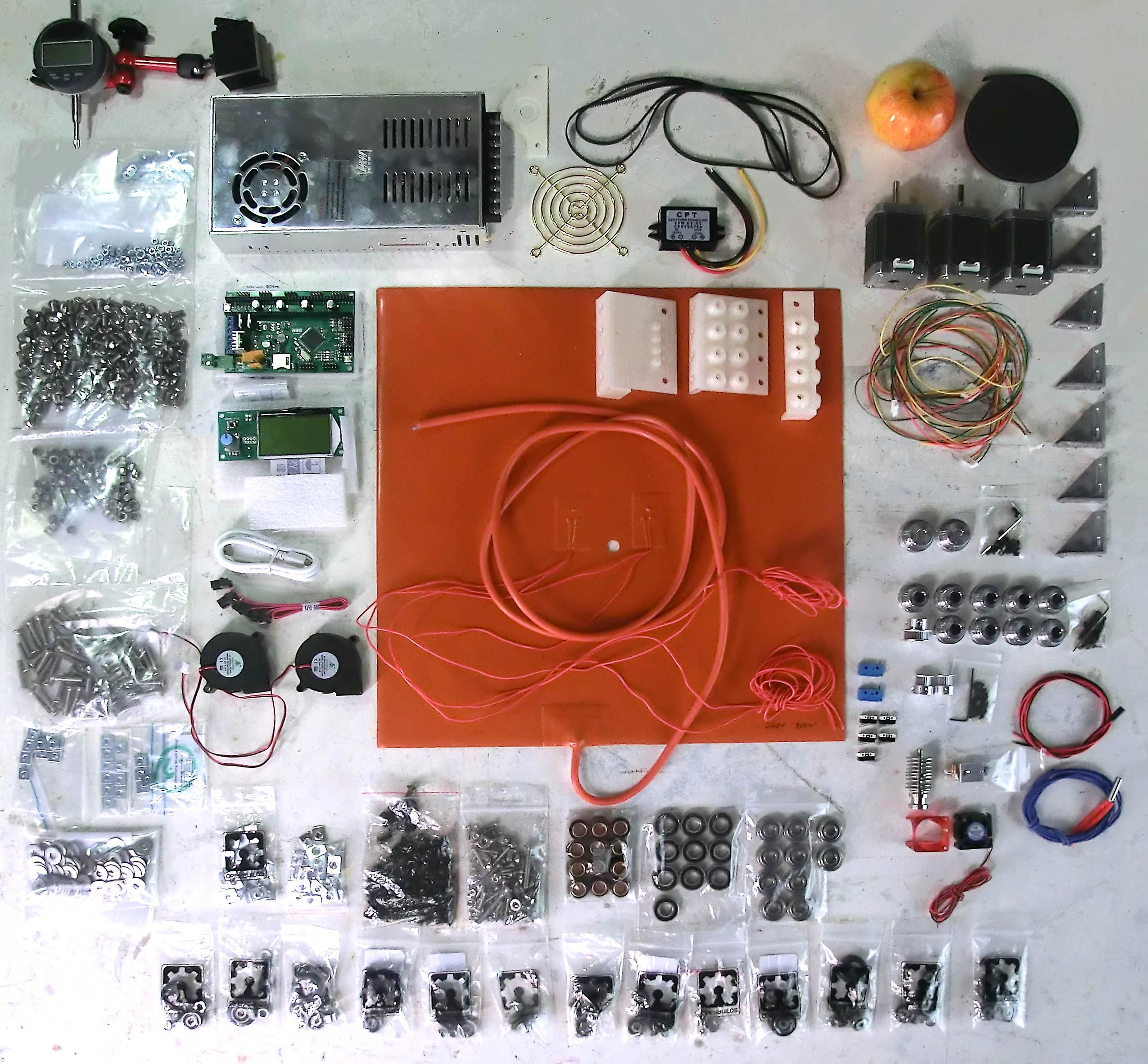

First Herculien print with some cheap PLA ,
trying to figure out the correct steps per mmm on the Z-axis. so far x y +z running on 32bit DRV 8825 but thinking of changing the chip on the z axis to a 16 bit one.
Setup of the AZSMZ-board (with its own Display ) was easy.
