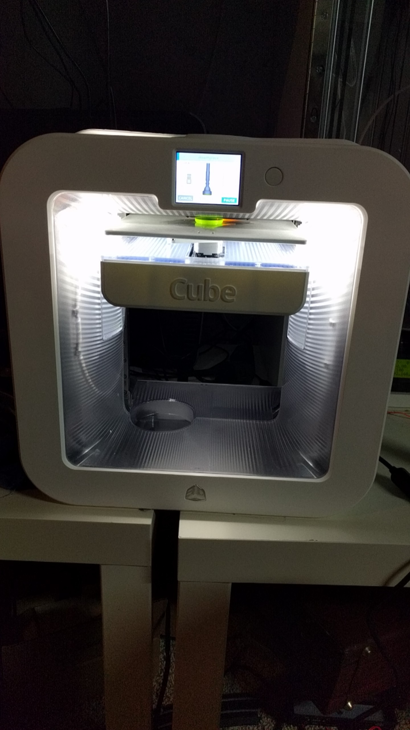

First impressions on this printer are very well.
First impressions on this printer are very well. A cartridge did jam the first print but I have fixed it. This printer prints damn well and has so much potential… And only $160. The only downside is the proprietary software and filament limiting the printer

@Fred_U I had the filament jam and break at the same time. Just opened up the nozzle holder and cartridge, pulled it out and heated up the nozzle so that I could get that off as well. Works fine now
@Abc_Def When you say you opened up the nozzle holder, do you mean the curved plastic enclosure that holds the nozzle as it enters the heating chamber? It’s been a while since I’ve taken that end apart and it didn’t fare well, but that’s because I have a lousy memory.
How did you manage to free the nozzle from the holder in order to put it back together again? Mine isn’t broken, but I’m serving as a tech support for the public library’s Cube3, trying to prolong the life of their soon to be extinct printer.
Okay, that’s just strange. I examined the nozzle I have and the entire enclosure slides “forward” and disengages from the nozzle within. Far easier than expected. Now to heat the thing up to attempt a clog clearing.
@Fred_U ​ send me a hangouts message and I will explain
@Abc_Def As an amateur Luddite, I don’t use the hang-outs, but managed to clear the nozzle using an SMT hot air gun from my soldering station. Also managed to soften the mounting plastic inside the top of the nozzle tube, which almost caused the nozzle to completely separate. Something for which I’ll watch the next time I have to perform this level of surgery.
I don’t think Luddite is the correct word in this usage.
The nozzle separated on mine. I then pushed the filament through and snipped off the clog
After the nozzle separated, you were able to push it back together without a problem? That’s an interesting development and gives me hope for some of the more damaged assemblies yet to be repaired.
I printed with it for about 5 minutes and had no problems so far
I would expect that the nozzle had cooled by the time you put it back together. Was it necessary to heat the nozzle in order to reassemble? If so, what are you using for heating the stuff?
I used a butane pencil torch. It had cooled but I heated it again. The nozzle can easily slide off still but i haven’t had I problem
