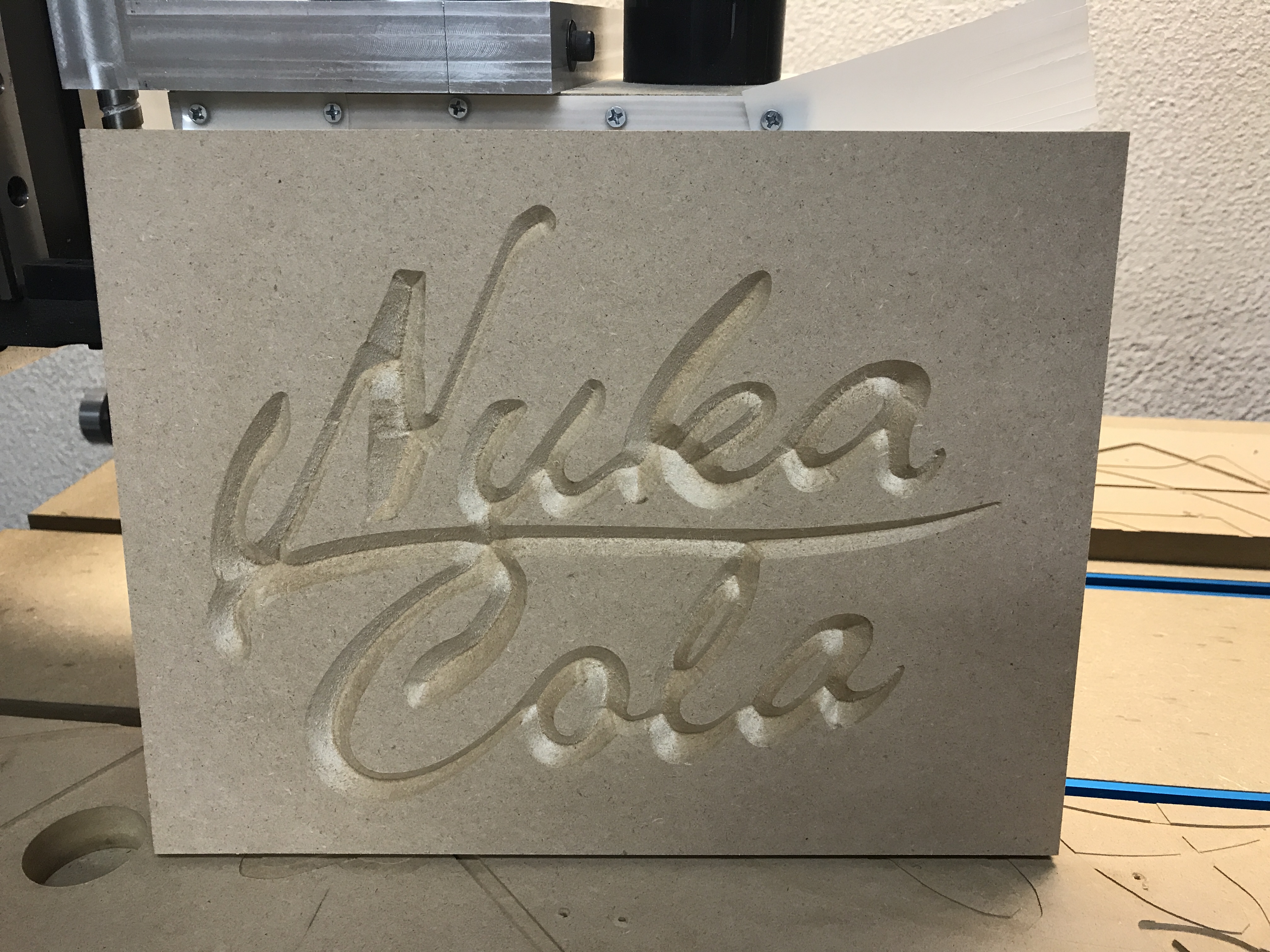

First Laserweb4 V-carve cut. Gcode generated by Laserweb but run on UCCNC controlled gantry CNC. There are some minor error artifacts compared to the one generated by F-engrave. The F-engrave gcode is much smaller and does a better optimized path. UCCNC ran the gcode smoothly and took less than 4 minutes to cut, no major gcode errors. Good job guys!!!
300x230mm
