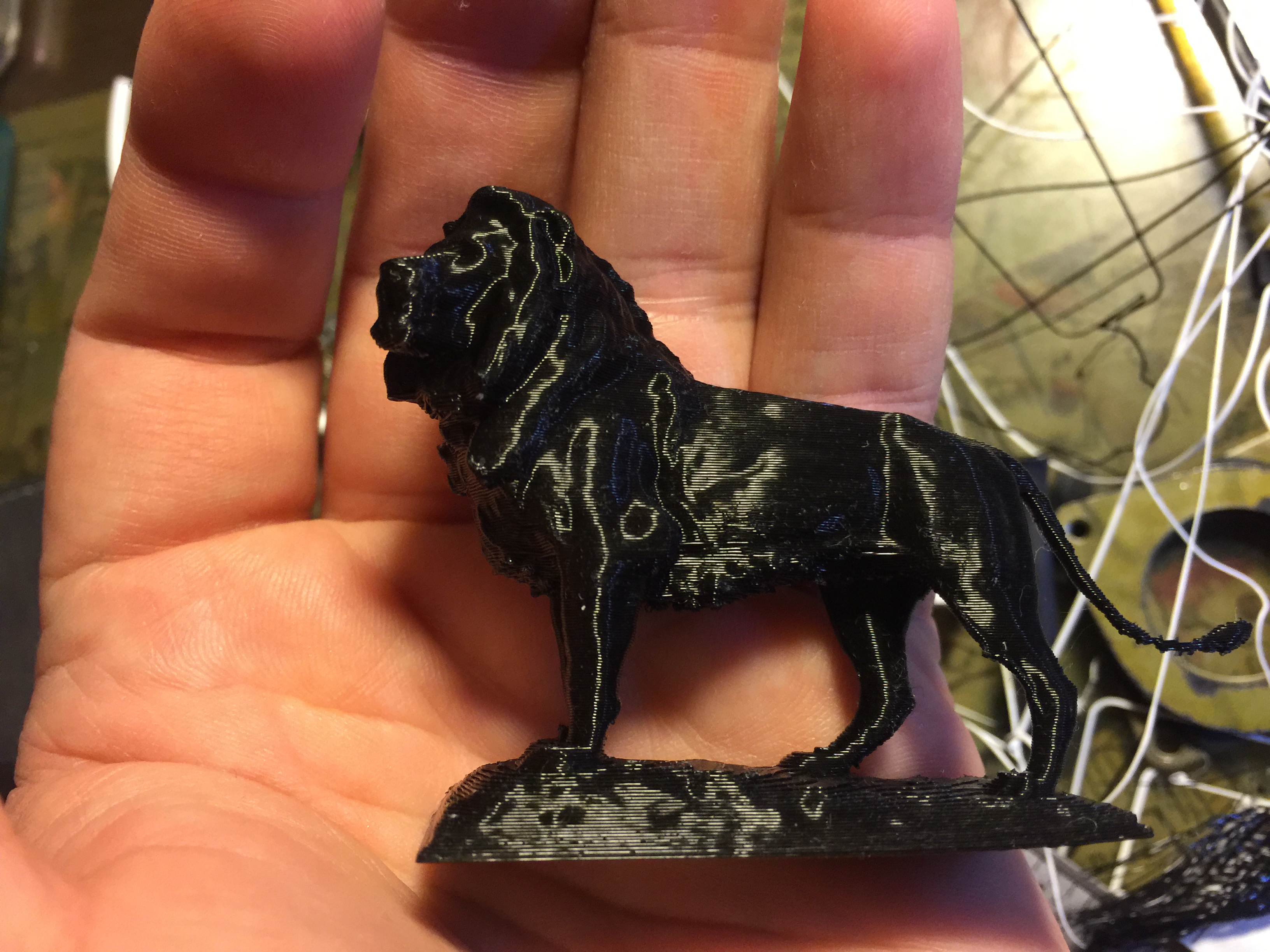

First longer test print.
ORD Bot Hadron that’s been through 4 years of changes and modifications, D3D hotend and extruder, 0.4mm nozzle (at the moment, i think), Oriental Motor steppers, 10mm/s perimeters, 20mm/s infill, extrusion width 0.3mm, 2 perimeters, 15% infill, 0.2117mm layers.
Some comparison prints from 2 years ago: http://www.thingiverse.com/make:69010
