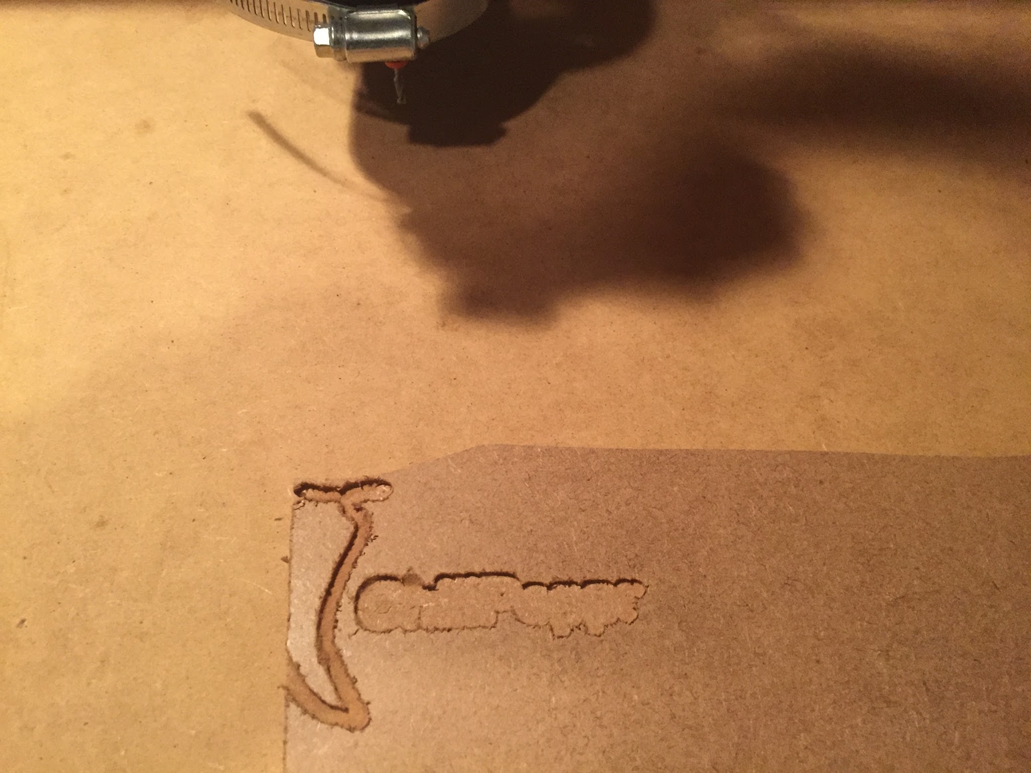

First movements and job with my “ox” (a 24x48 frame with 20x60, gt2 belts, and nema 17 instead of the more overkill components) running the grbl workspace on a 6 year old Inspiron 1525 laptop. Works great. Time to jump into aluminum.
Awesome to see that ChiliPeppr as first run again on a brand spankin’ new build! This looks like a nice big machine.
