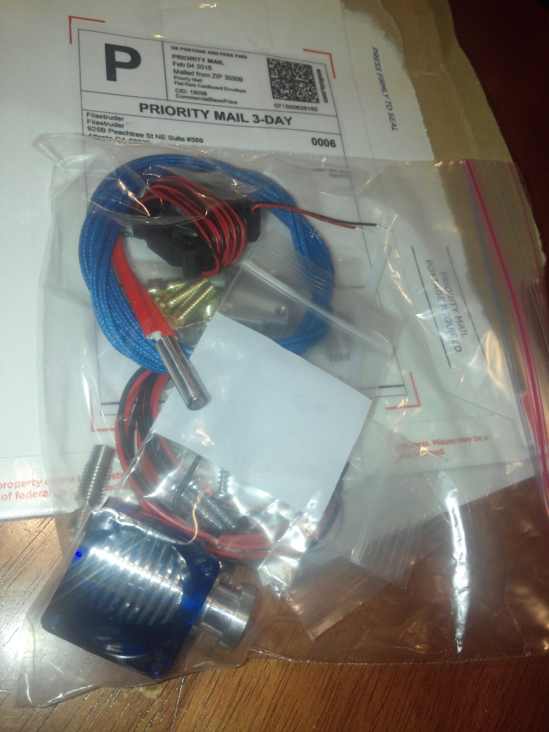

First of the many orders for a Herculein build has arrived. Probably a month before I get them all, but exciting none the less! I am building with one extruder, E3D Volcano 1.75 Eruption. Thanks to Filastruder for a fast delivery!
Sounds awesome Bruce. Now that you are on the list to get the Smoothieboard, it will only be a short time before more stuff are in place. I still need to get more electronics (heated bed, bed platform, …)
