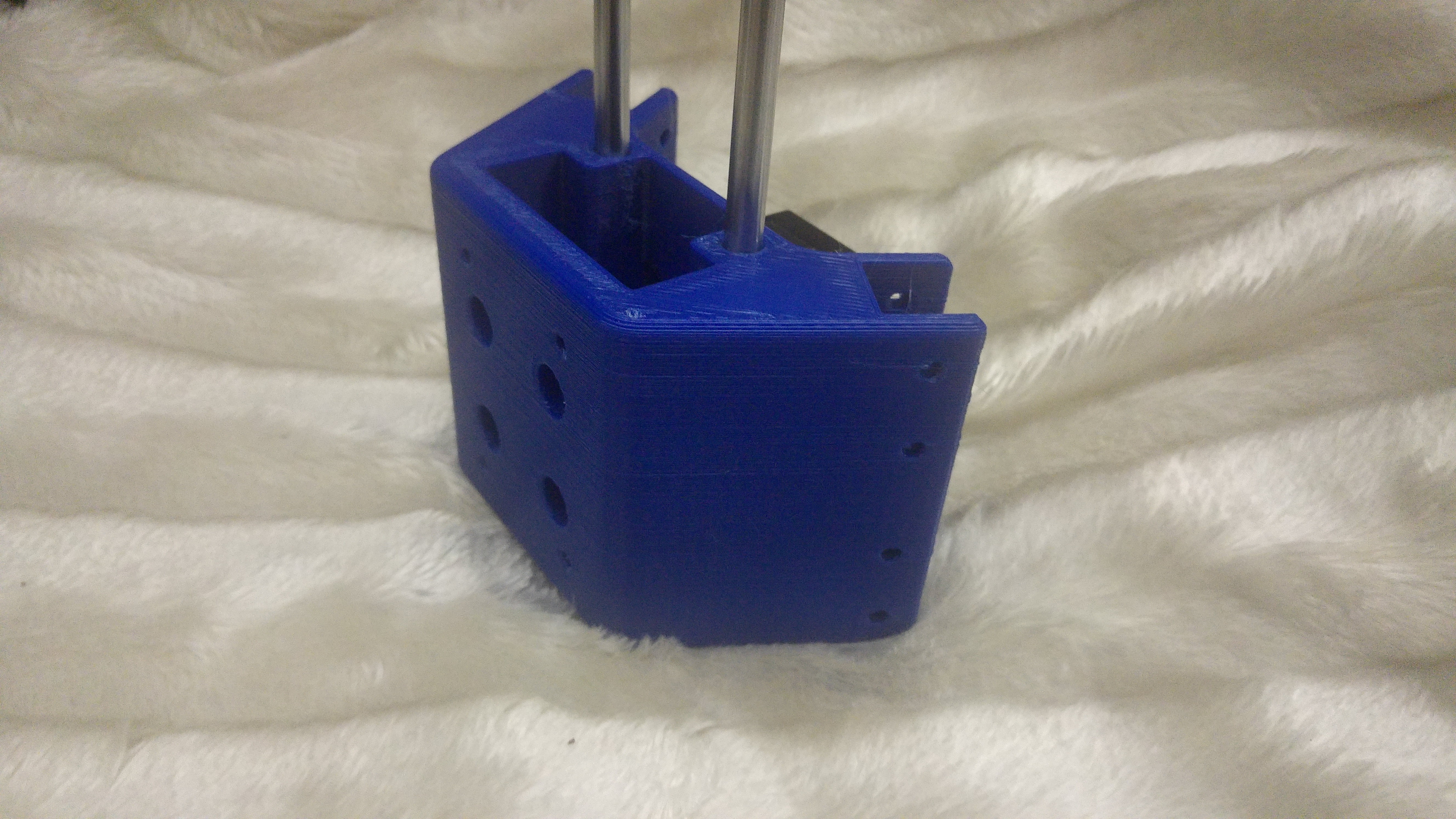

First part of the new AX-02 Delta off the printer.
First part of the new AX-02 Delta off the printer. Printed with a 0.8 nozzle at 0.5mm layer height in Formfutura HDGlass. This thing is going to be a monster…
You know you could eliminate the need for the smooth rods by ising the right kind of slide setup on the rails.
I am using these derlin pads on mine they work perfectly. No slop slides smooth and no need to oil ans derlin is a self lubricating hard plastic.
Fully realise, the whole ethos of this is overkill with a solid frame, the rails will add a little extra rigidity to the structure.
Don’t you already have a printer farm? Would love to pick your brain sometime of common issues I face regularly that may be a simple fix
@Alex_Krause - I do, this is a replacement for an unreliable Chinese Prusa i3. If you need help, I’d be happy to chat…
Those corners are monstrous! yay! :smiley:
@AlohaMilton - yeah If I do overkill, I do overkill. External dimensions are about 375mm wide 575 deep and 710mm tall. S’gonna be a big bastard.
