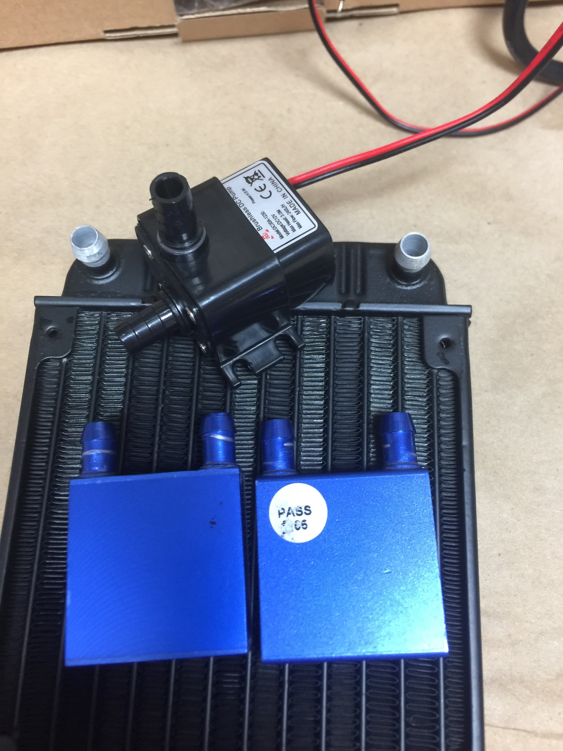

First parts arrived for chiller
Are you doing a Peltier system? If so, what is your layout?
@Steve_Clark I am doing that. I haven’t yet decided on the flow yet but to keep the system from working to hard I am adding the radiator to help take the temp Down before it hits the chiller. It will be in an air condition room in the mid 70’s
Got it. How much functional Peltier wattage are you starting out with? I’m just curious as I’m building a system right now and have posted here a lot on the subject. I’m always interested in what others are using and doing.
