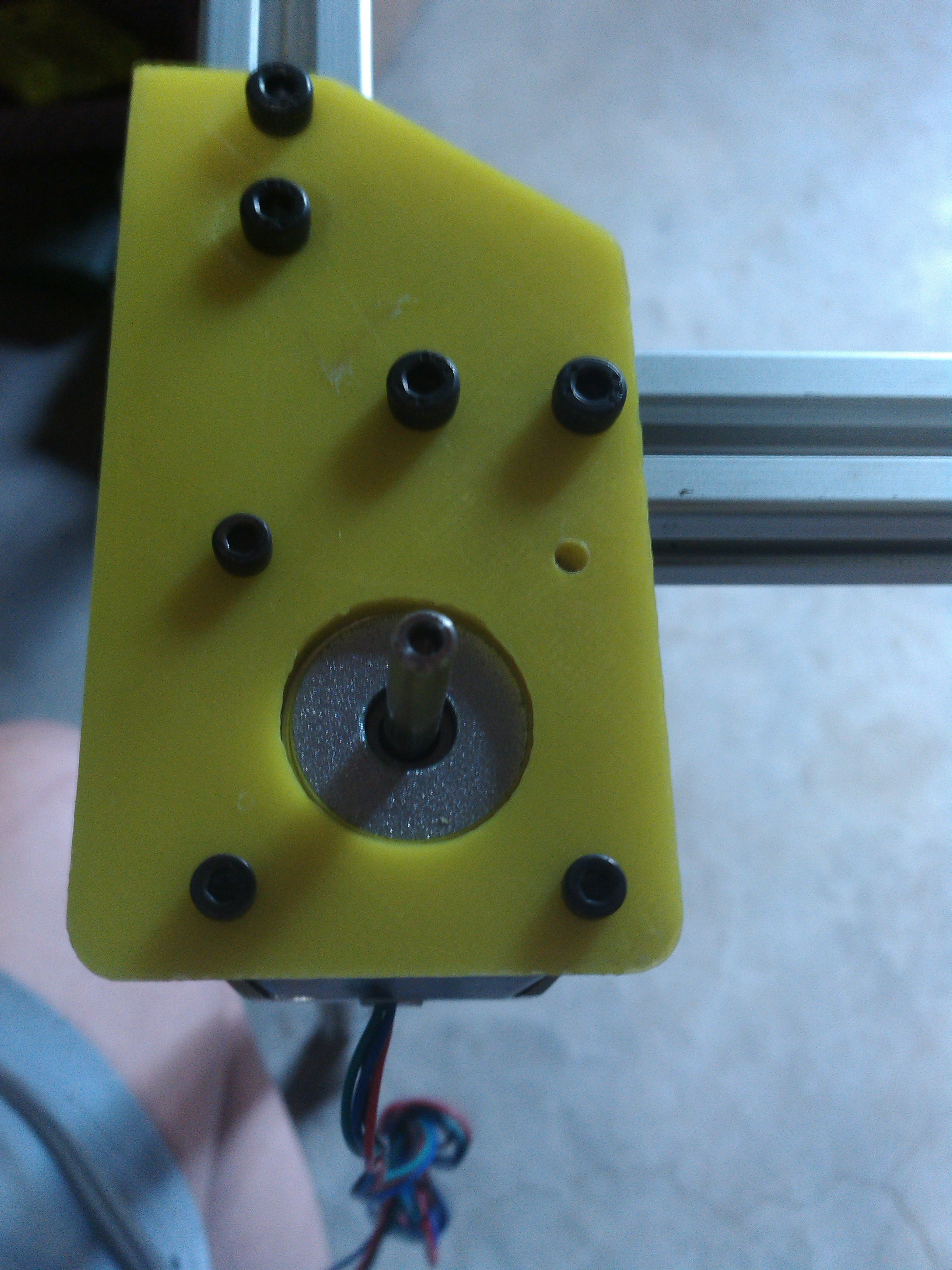

First pieces for the 24 x 24 x 24. Stepper and idler brackets.

Ah. Engineering looks great, though. Are you basing it on expanding an existing design or creating a new one?
Yep Solidoodle2. I will call this printer a " mashup ". From what i have seen online and a @Tim_Rastall frame design to how ever it ends up to get everything to line up kind of engineering. I have two of these to build so once i get the first one done then the second one should go somewhat quicker. I have two 12mm ball screws 700mm long to use for the Z with dual 12MM smooth rods for each side. 48mm steppers for the X and Y. Two 42mm steppers for the Z’s. 12mm rods for the Y and 10mm rods for the X.
