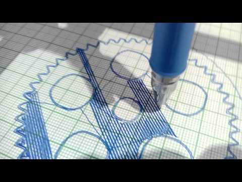

First plot with #bigQr100
Would like to try your circles test, I thing my circles are not round as they should be.
