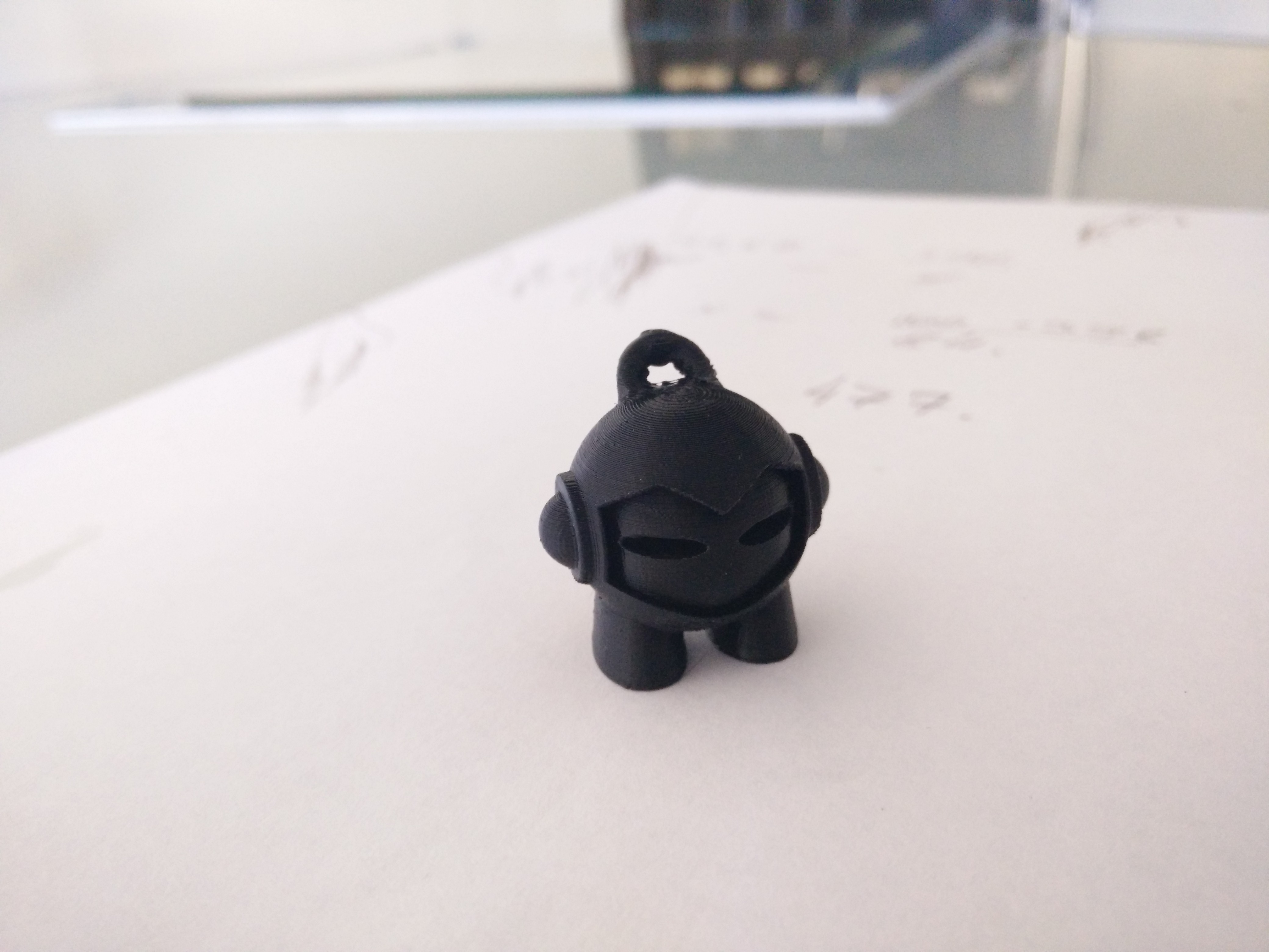

First print after my machine was rebuilt. Some kinks are still there but now I know that if I slow down it will be perfect. 0.192 mm height, 40 inner, 35 outer, 50 infill, 3 mm retraction on 50mm/s. Bed 60. Sliced with Cura.
Looking great. Can’t wait to see some printing vids. I always have trouble with that top loop. It’s a bear unless you print it at a snail’s pace. I never liked going slow on my printer
It was intended to print fast. I will be posting my progress regularly with comments and suggestions. Any experience worth sharing. Plus as soon as I will get a bed cut, I will start printing ABS for the next person in line for Print Forward. My bed is now a retrofitted PCB Mk2a with aluminum heat spreader. It didn’t like ABS at all.
