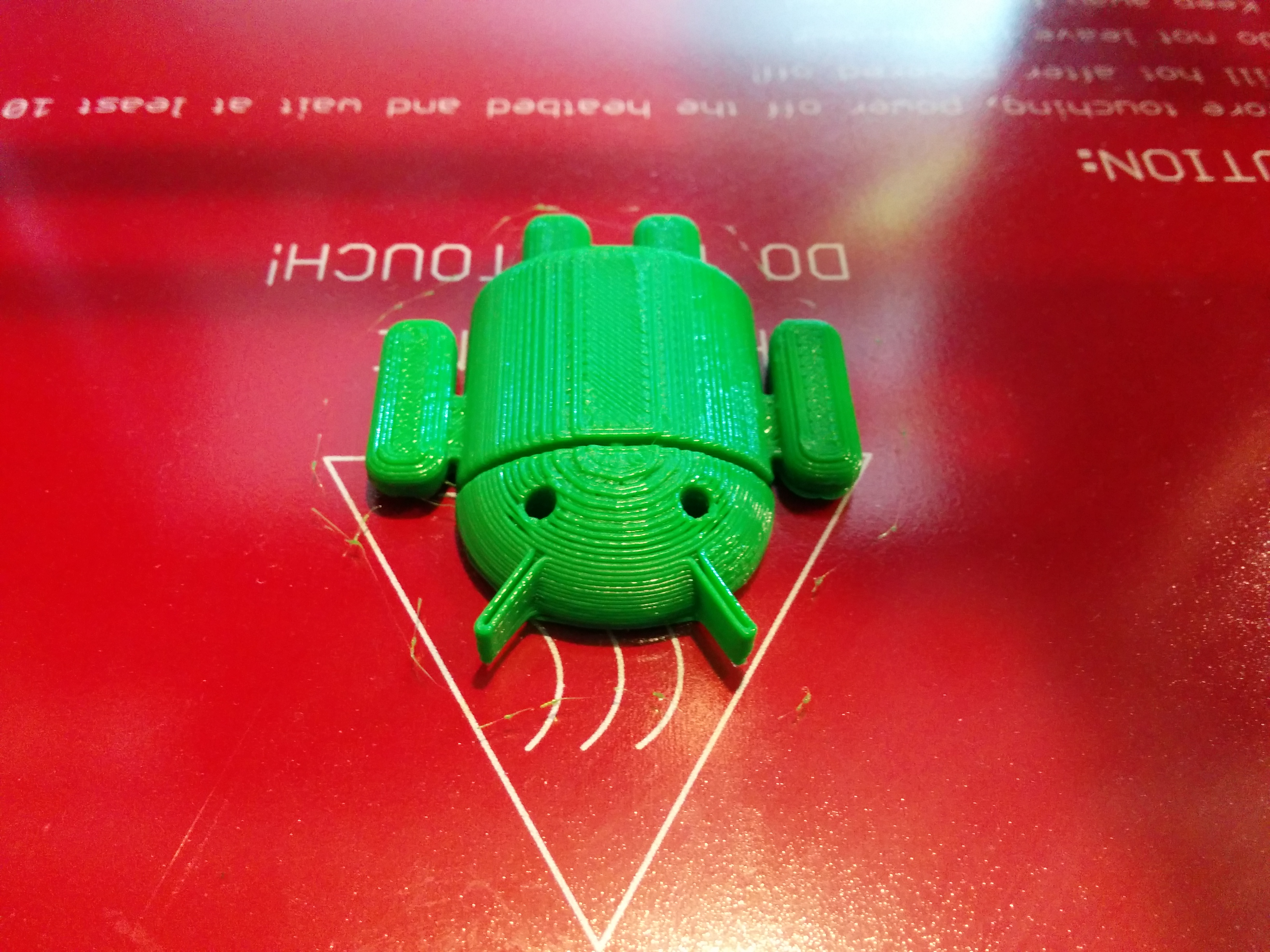

First print from my Mendel90 kit from nop head   This was printing the
First print from my Mendel90 kit from @nop_head This was printing the g-code included in the kit after leveling the bed. It was very nice to have pre-sliced g-code to try so I could print something before getting slicing figured out. The kit is excellent and I think it is a great way to get started with 3d printing. Having skeinforge profiles provided with the kit was a great help as well.
