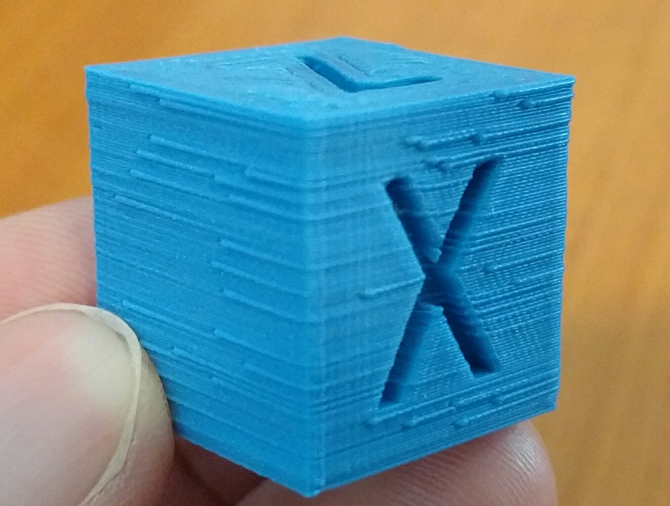

First print of calibration cube on an i3. Any tips on what is causing the lines and how to fix it?
Look at your slicer settings for travel distance in the XY direction. Looks like your nozzle is traveling outside the print but not far enough and it is drooling. Also over extrusion?
Thanks. I’m new to this and my friend’s printer gets great results (also cost $$$ more) so I’m a bit frustrated at not being able to replicate similar results. I’ll take a look at the travel distance and google for how to tighten the straps.

Are you using “retraction prime amount” and a random z seam? it looks like too much (btw. cura didn’t calculate this by the time or at least travel distance - it is a fixed value)

@Philip_Money_Mongoos I would assume that there are two issues. on the dodecahedron cooling is one … on the cube this partly overextrusion (probably where he start a layer) doesn’t seem to be cooling related

my best guess is over extrusion starting a new layer, temperature of hotend a little high, and part cooling being needed.
not sure the settings in Cura but in S3D a negative restart distance is one way to deal with over extruding at the start of a new layer.

Just here to repeat what Ulrich said. The thick beads at the start of a layer look like they’re related to the retraction settings.
@jesse_dean you mean too much or too little retraction? It is currently set to the default on slic3r. From memory 2-3
Well retraction by itself retracts the filament at the end of a bead, and then advances it the same amount at the start of one… so that shouldn’t cause excess on it’s own.
However (and I’m not familiar enough with slic3r to say for sure) lots of slicers include an priming setting which allows extra filament to be pushed during the advance. If there is minimal drool after a retraction, then zero should be safe for the priming setting.
Again, not an expert on slic3r, but that’s what I see in the print.
