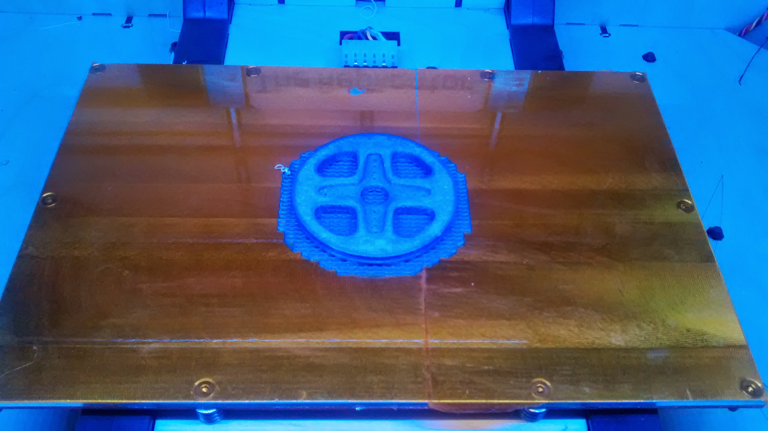

First print of PET+ from MadeSolid using 240C on the extruders,
First print of PET+ from @MadeSolid using 240C on the extruders, 100C on the bed and a raft. Next print is leaving off the raft. Better definition than the ABS part, started a bit hotter on the hot end (245C) but got a lot of goo so backed it off to 240C. The raft adheres a bit too well to the part. Interesting ‘shine’ effect which isn’t there with ABS either. Surfaces were good and the small overhang on the edges had no droop at all. Now to find something a bit more challenging for it to render.
So the non-raft version has a much better back surface (smooth and shiny) but it was quite a bit harder to pop off the capton tape. Not freeze spray hard, just wait until the bed was much much cooler and then pop it off with a plastic wedgie hard.
