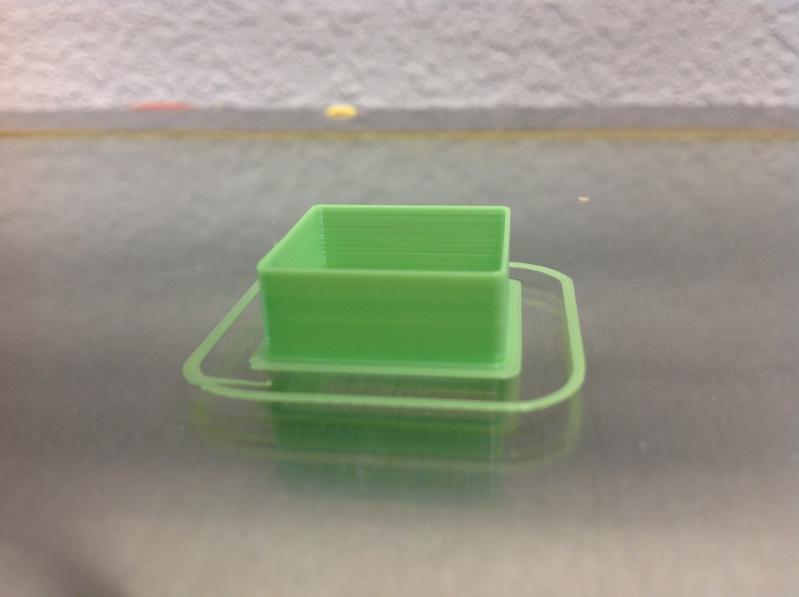

First print off the Ingentis/Eustathios. Turned out pretty good I think. Still need to figure out print speeds with it.
Very nice! Layers look pretty uniform.
I’m still playing with speeds a bit myself. I’m using Cura, at the moment, and off the top of my head, I believe I do 20mm/s for the first layer, and then 20 or 30 for the outer perimeter, 40 for the inner, and 60 for the infill. Works pretty well for me. Maybe it’ll work for you as well.
