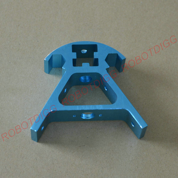

@Thomas_Sanladerer yeah, the corners hidden under the black covers are pretty thick aluminum casts. They don’t allow the machine to flex or wobble as much as you would expect for this size. The T slot bolts into about 5mm thick aluminum corners.
Like this: http://g03.a.alicdn.com/kf/HTB1WIZxHFXXXXahXpXXq6xXFXXXO/Metal-Corner-for-Kossel-of-2020-OpenBeam-6pcs-F623-included-.jpg
Except for twice as tall,
