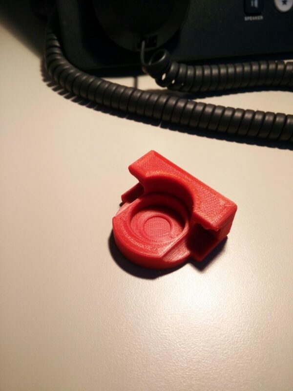

First print. Some imperfections are still there but nothing that can’t be fixed. Red PLA. Dimentions are spot on. Today I’m going to try printing a new extruder
Looking good.
Very nice, what print settings did you use? temp, layer, speed etc
.1mm layer hight, 200 C, PLA, 40% infill and 4mm shell. That was a slow print, 2 hours on 40 mm/s with 30mm/s on the outer layer
Thanks for that info, it looks great and what machine did you build? Was this done on Slic3r or Cura?
I will definitely have to slow my prints, thin out my layer and have more patience. Initially I was thinking 20 minutes on that part you printed.
I wanted to print so badly so I decided to assemble it from what I have. Eventually it will be spider V2. But for now you might find some hot glue in strategic places. Model was sliced with Cura.
