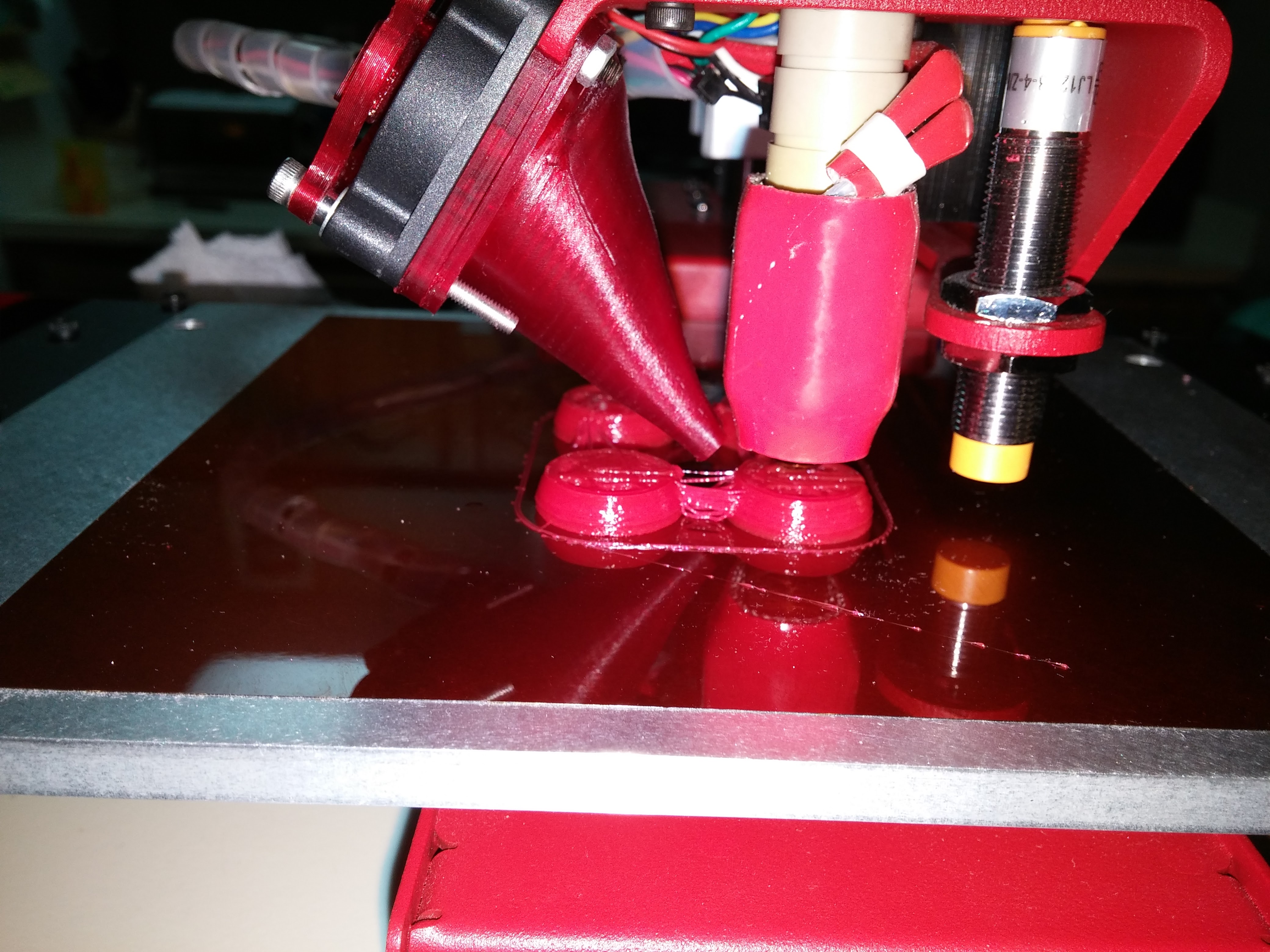

First print with Fire NinjaFlex. Decided to print the stabilizer feet provided by @Printrbot on their YouMagine page. I printed them in red PLA originally but turns out they were actually made for printing in NinjaFlex. Looks like I won’t need those little rubber stickies to save my surfaces anymore once these are done printing.
Concerns so far. Adafruit suggests using their addon but it didn’t work for me. Looks like printing at 30% speed and upping the flow a bit is getting good results so far and no buckling in the extruder! I turned off retraction like they suggested but it’s causing quite a bit of gooping from one item to the other. May test out some retraction settings after this print. Any suggestions?
I don’t think any kind of retract will make a big difference. Regardless how much or how little i tried i always get stringing. Speed was no issue tough, i designed an extruder specifically for soft materials.
I also have this issue which I could not overcome.
Ok, i’ll eat my words, 10mm retract took care of nearly all stringing for me
