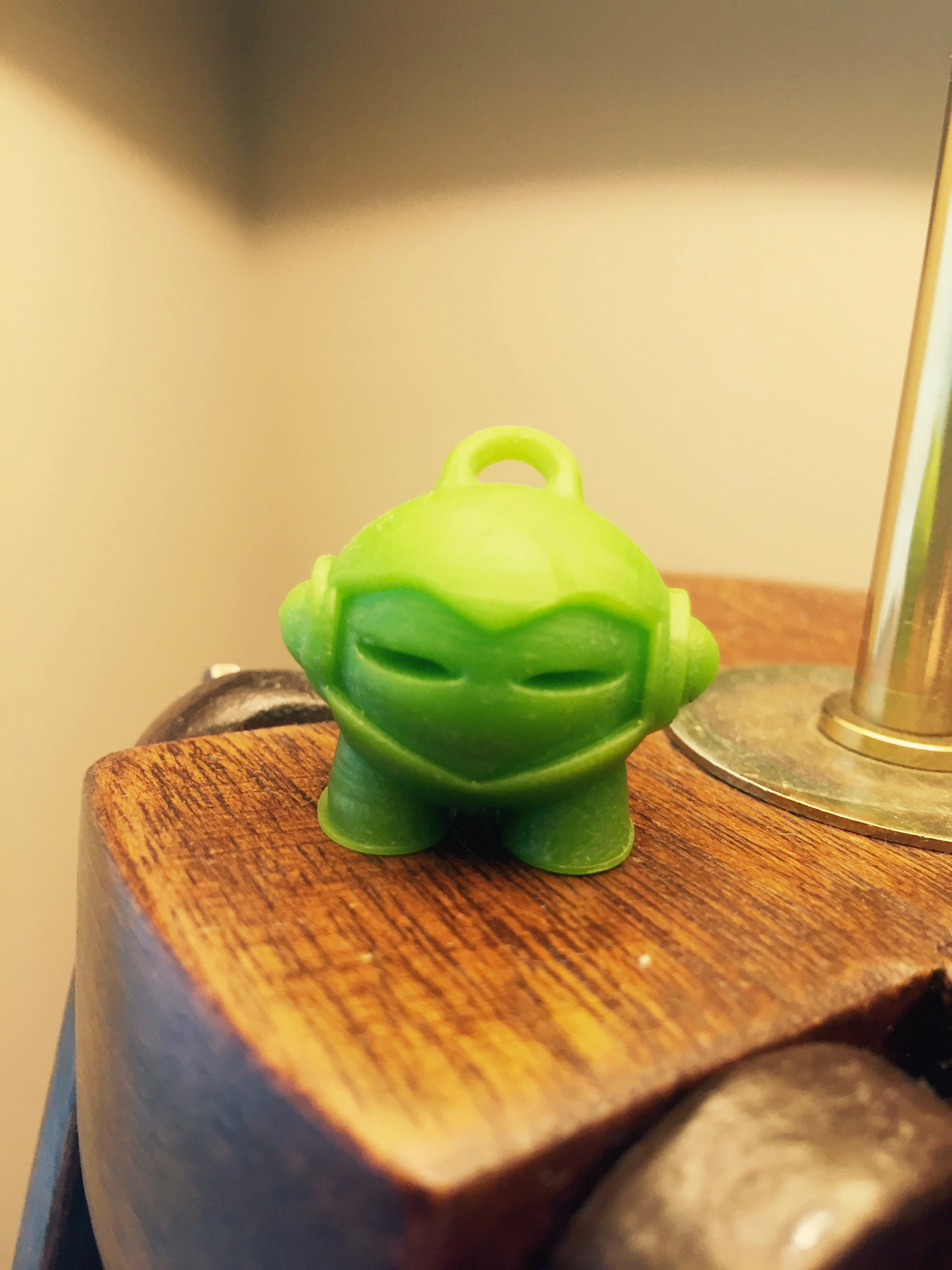

First prints off the new FEP flexi-vat for my LittleRP.  Works a treat!  Marvin
First prints off the new FEP flexi-vat for my LittleRP. Works a treat! Marvin was printed before I recalibrate to take into account the change in the focal distance, so he’s a bit squashed.
So flexi-vats are all the rage now. Nice! Now, if you guys can get ahold of that Teflon AF stuff that the super fast resin printer is using… :slight_smile:
@ThantiK
:slight_smile: think there’s more to it than just the membrane, but yeah, it’s progress. Have to say, so far I’m impressed - a lot better
release than PDMS
Looking good! :slight_smile: I can’t wait until I have mine done.
