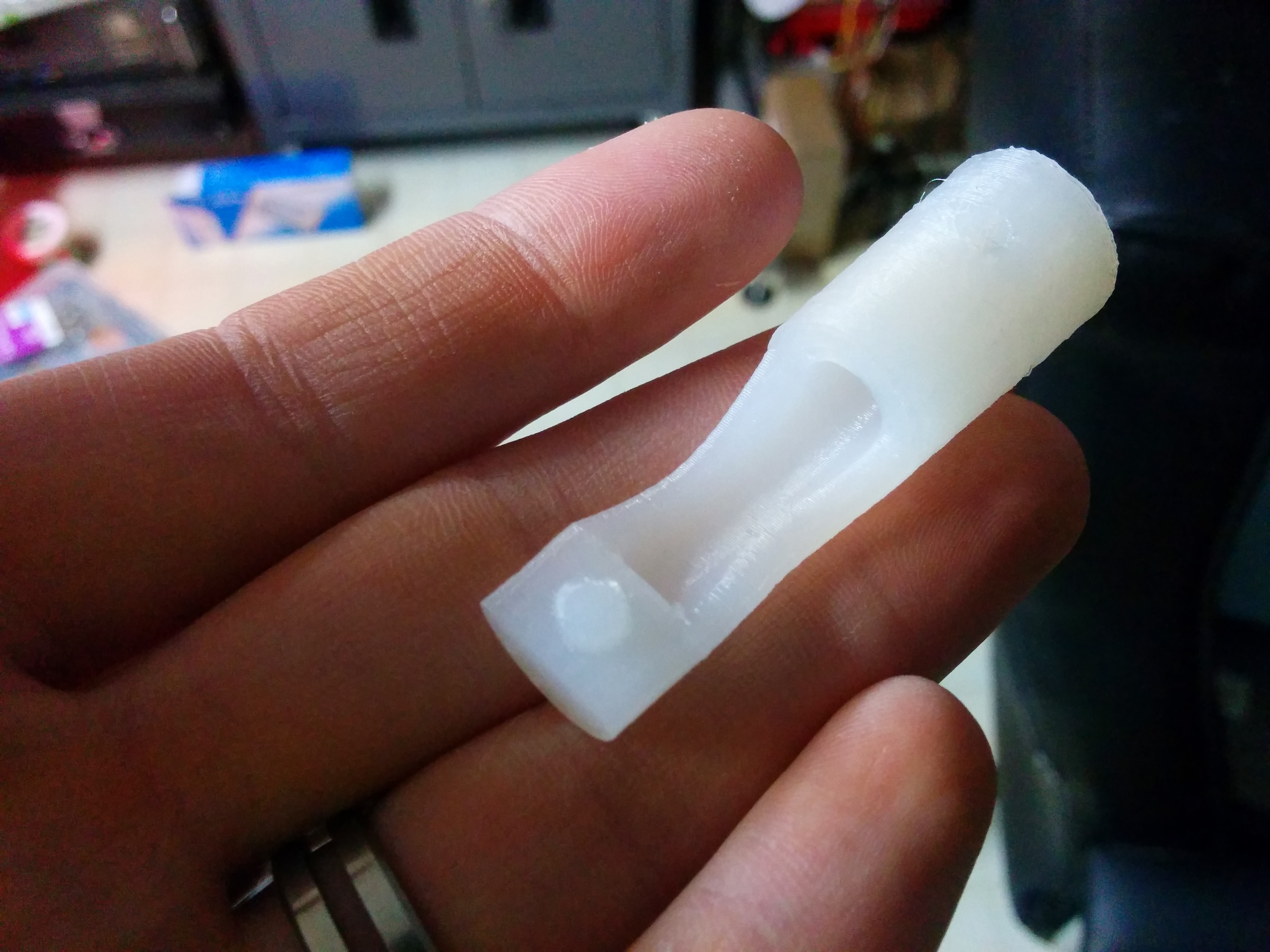

First prints with Bridge from Taulman. I love this stuff.
First prints with Bridge from Taulman. I love this stuff. No supports and that little pin was basically printed in the air.
Printed at 245c in 60c glass with a 75:25 mix of PVA to water painted on. Bed adhesion was fantastic and no warpage. The layer fusion on this stuff is amazing. I tried pulling apart with pliers, separating it with a knife and its still as good as new. Ive also ran some parts through the dishwasher with no ill effects.
That little pin is fantastic, how the hell did it manage that?
Magic Id guess. All my settings are what I would normally run for ABS other then the temp changes.

@Jo_Bigger its my own design that I haven’t been very vocal about but that will be changing soon…
I printed at .2 layers
I’m not sure about temp but I was impressed with the dishwasher. My water is HOT and deforms all kinds of stuff.

these were set to 90 for perimeters and 100 for infill. They were printed solid. Thats what I usually print abs at. The nylon feels like it flows just as well if not better
