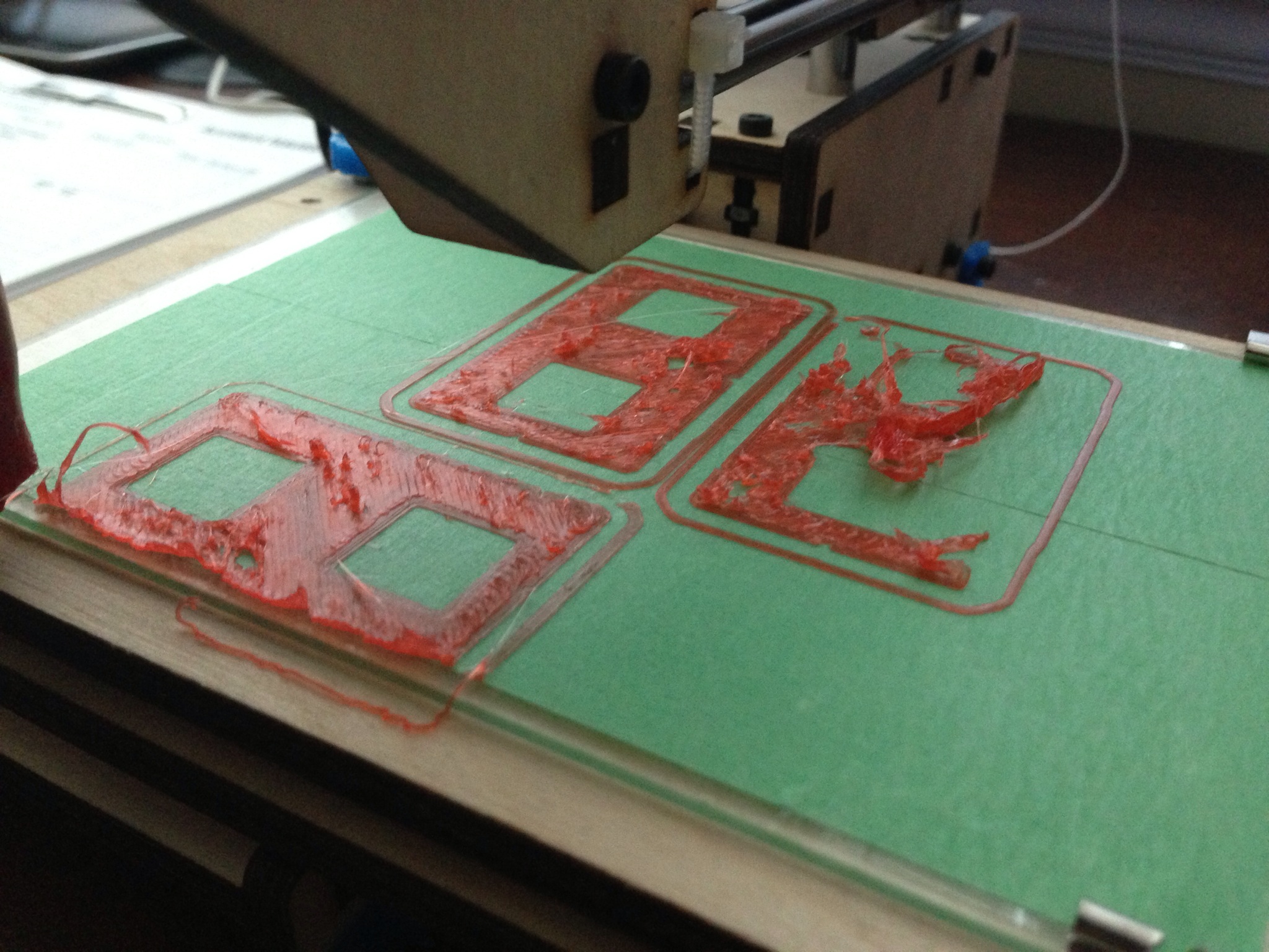

First prints with new colour PLA. Same manufacturer as my blue and green PLA, but this stuff seems to behave a lot differently. Specifically, it seems like there is too much material being deposited for the infills, so it’s globbing up and pulling away from the bed. I’m getting this behaviour with Repetier’s built-in Slic3er and with Kisslicer, so it doesn’t seem to be a slicer-specific issue. Anybody have any suggestions?

Do the slic3r thin wall calibration test. You’re extruding too much.

@Andrew_Litt OK, I’m extruding too much. How do I fix that?
@Shachar_Weis Dropping the temperature doesn’t work - I get really bad first layer and intra-layer adhesion, really bad stringing.
Did you measure the “diameter” of the filament with calipers? This varies as much as any other quality from filament to filament. It’s generally not round, so I take two measurements and just average them, to the hundredth of a mm. This makes a big difference in terms of over- and under-extruding.
Yes, but my calipers are only tenths (I’ve got a hundredths set ordered) so to the best of my measurement capability, there’s no difference. If it were a dimensional problem, how would you adjust? Tell the slicer the filament is larger so it throttles back?

https://github.com/alexrj/Slic3r/wiki/Calibration guides you through running a test print, making measurements, and adjusting Slic3r’s extrusion multiplier to compensate. If the multiplier winds up being too great, you might have better luck with Triffidhunter’s excellent Reprap calibration guide: http://reprap.org/wiki/Triffid_Hunter’s_Calibration_Guide
The e-steps fine calibration in the second link will get you close even without precision calipers. It takes longer and is a bit subjective but works well.

Yep, what they said. You can use the extrusion multiplier to get a good result, then go back and figure out which of the other calibration variables is wrong. Your E motor is moving farther than Slic3r thinks it is or the material is larger than Slic3r thinks it is, or both. Your 0.00 mm calipers will help a lot. Good luck!

By the way, I’ve actually done extruder calibration using a marked segment, so I’m certain that I’m no more than 5-10% off there, and like I said, my tenths calipers are telling me the filament is 1.7mm, maybe 1.8mm. Logically, I could be no more than 10% or so off, so that’s the type of amounts I’ve been tweaking by. Just for shits and giggles, I applied a flow rate compensation of 0.7 in Kisslicer, in addition to a 1.8mm filament dimension. My infill, though still a little much, is greatly improved. I’m shocked - I can’t believe I’m actually off by 30%, even considering the effect of cumulative errors and a filament change - does this actually seem likely to anybody? Have any of you seen this size compensation being required?
Look at X,Y, and Z too. If you have inaccuracies there, you could easily get to that kind of cumulative error! Again, the calipers will help. Sounds like you’re on the right track!
