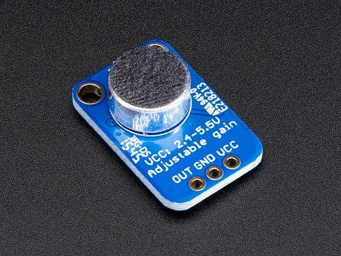

@Tommy_Sciano but i used another electret. This one: https://www.adafruit.com/product/1713
I’ve found a big difference between “loud music” and “at a festival in front of 50,000 a Funktion One system”. Interested to see how you go on just a bare electret. You might have better luck with it on top of a hat (vs. mine on a control box in a pocket.)
On the board, is has 3 gain settings, i can modify it with jumpers. Microphone ich s on a 1m cable, so i can test perfect position.
