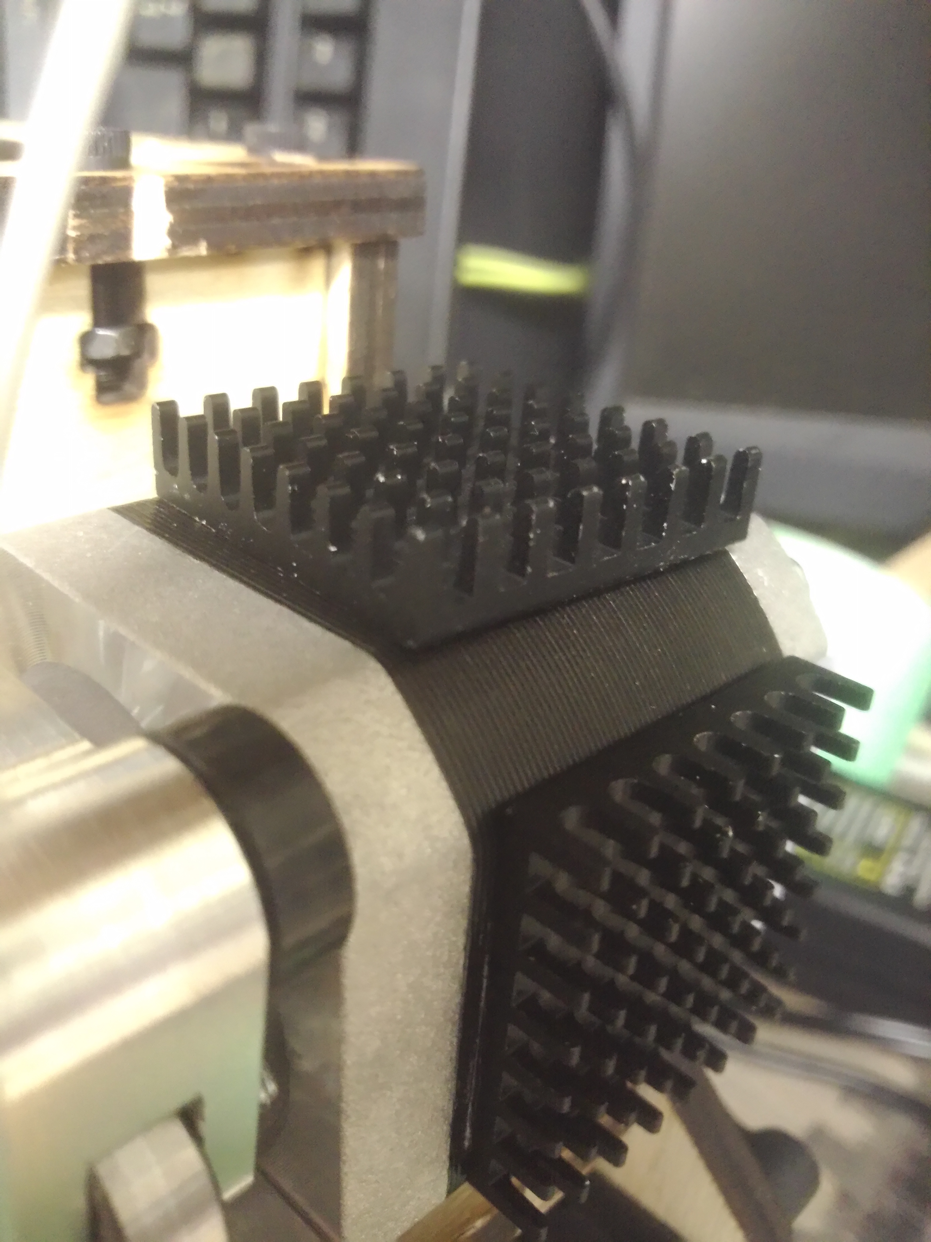

First real "failed" print. The extruder started skipping steps.
First real “failed” print. The extruder started skipping steps. I noted a potentially loose wire where the stepper plugs into the board. Also remembered people saying steppers loose steps if hot. So I tightened the wire and crazy glued a couple heatsinks to the motor.
Next print worked!
I wonder how well that glue conducts heat. If it is a poor conductor then it will capture heat inside the motor and prevent any of the previous airflow from reaching it.
Good point - I had heard elsewhere of people crazy gluing heatsinks to the chips on the Polulu drivers, so I figured it should work here.

Yup, I did that current adjust procedure a while ago - at first the extruder motor was very warm, after adjusting, not so much. But still warm.
If you can touch the motor and leave a finger on it, I don’t think the heat sinks will have much useful effect. I’d suspect it was more likely the loose wire. But they won’t hurt anything, either. :wink:
Adjusting the current is true in most cases, but not with the printrbot and their aluminum direct extruder. Many of us have already been down this road and the only effective remedy is the heatsink or heatsink/fan combo.
Yes. Not just the aluminum extruder, the wooden direct one as well. I’ve never gotten PLA feeding through reliably without cooling the E motor.
(The problem isn’t that the motor gets hot, it’s that it heats the PLA)
So, if I do decide to add a fan to this, it would seem that the goal should be to blow on the extruder to cool it and the PLA down?
I’ve had really good luck with cheap CPU cooler fans on motors. Temperature reduction on long runs is rather amazing.
