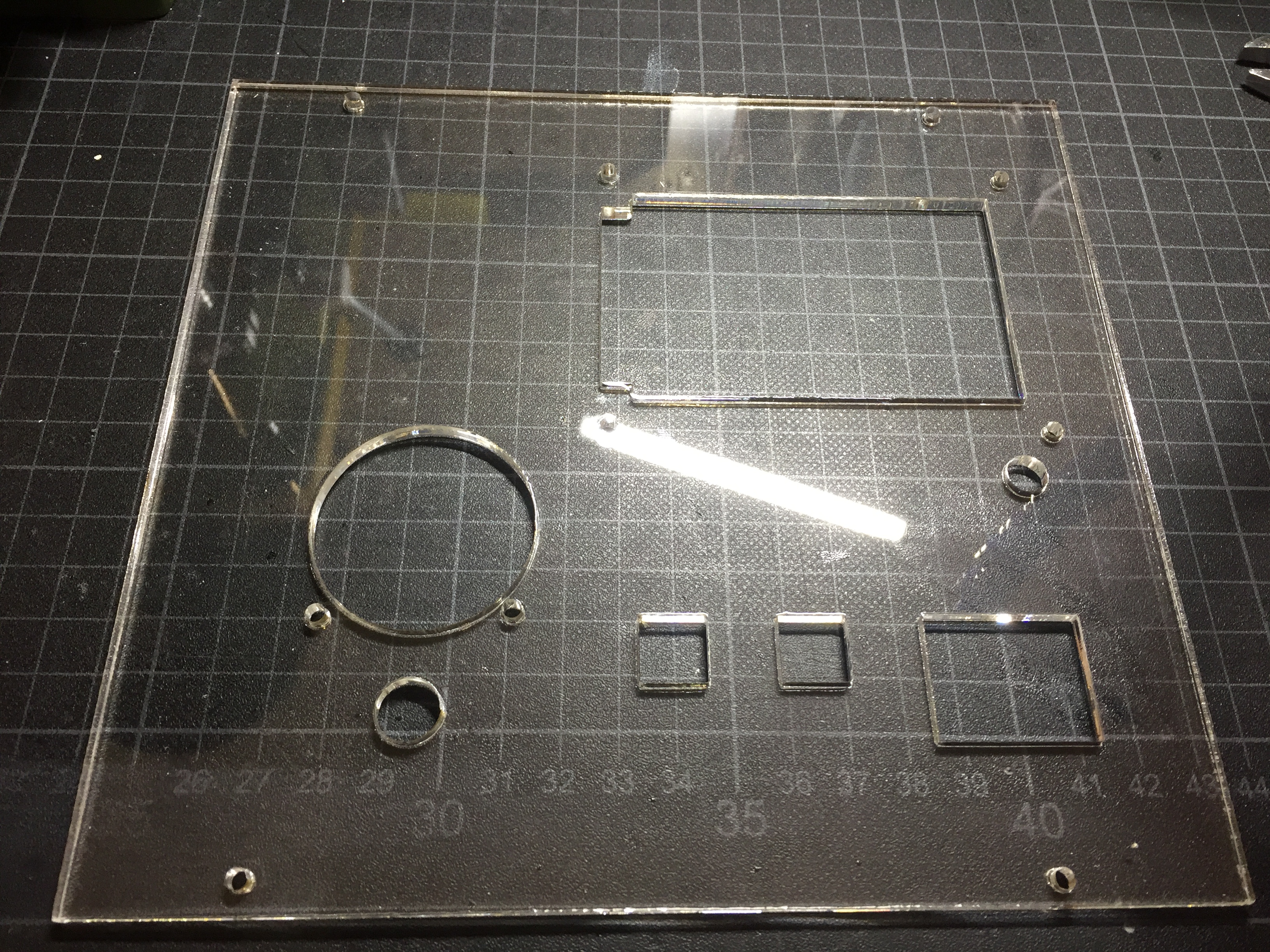

First results with the freshly modded mashine. Cut out a new control panel for the GLCD of the Smoothieboard. Worked pretty well. Also 3D carving tests but I need mode practice and tests to find the right numbers for movement speed and laser power. PWM seems to work though so no rewiring required to have 1 PWM line and one enalbe line. All done with PWM on the L line of the power connector.

This is the SVG file. It has the holes for the power switch, amp meter, amp pot and push buttons. Also the mount for the GLCD. Please note that the mounting holes of the panel it self are off! The did not fit 100% and I had to adjust the holes a bit. The other measurements for the mountings are on point.
