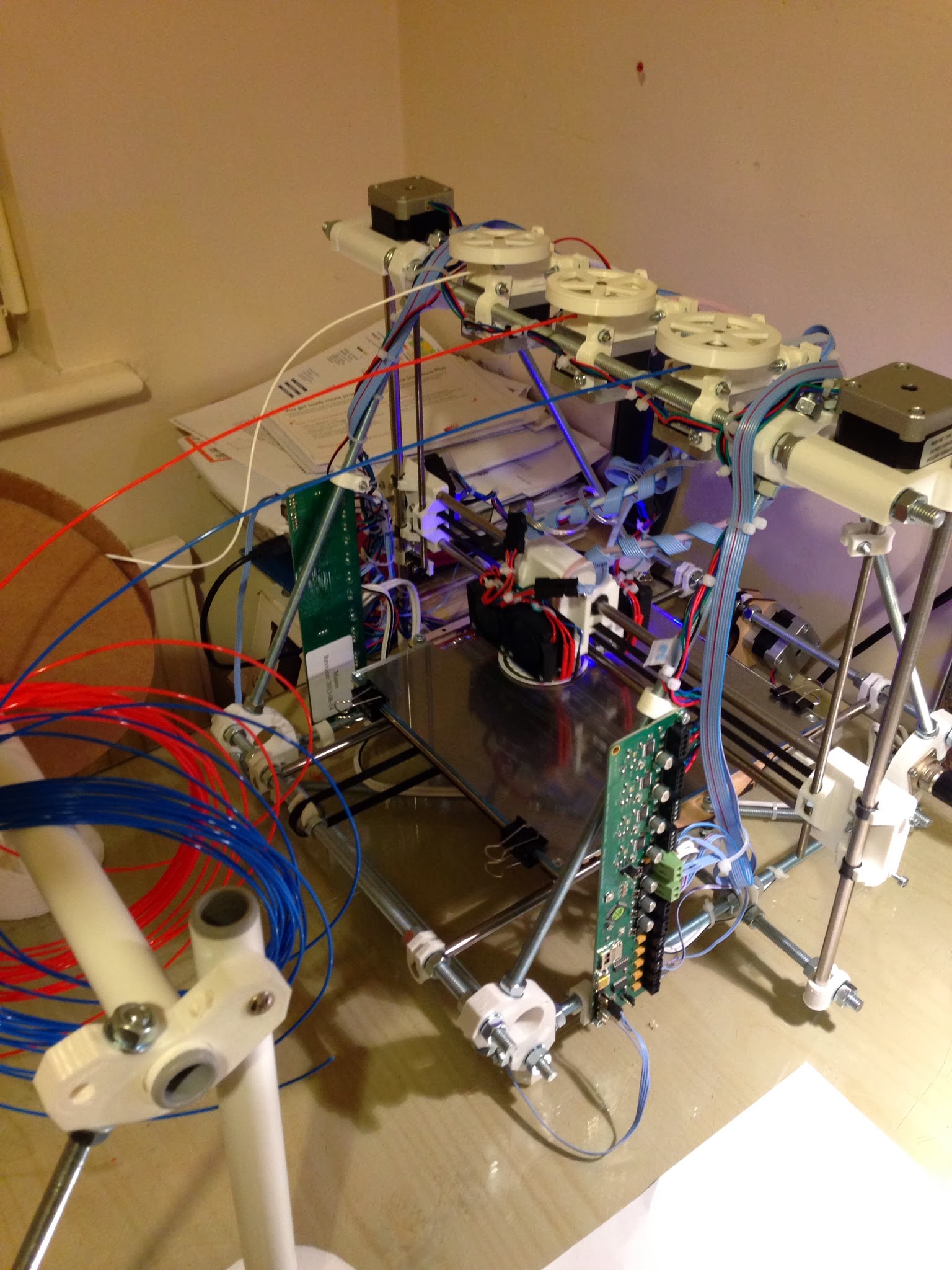

First steps and all that - my first print having upgraded RepRap to tri
First steps and all that - my first print having upgraded RepRap to tri colour.

What is the name of those parts that help feeding ?, you have 3 of them on top, also, what kind of electronics do you use ?
Extruders - there are three on this version.
http://www.reprappro.com/documentation/RepRapPro_Tricolour_extruder_drive_assembly
The electronics are a master (hot bed, x-y-z axis drive, extruder 0 and associated hot end, fans) and a slave (extruder 1 and 2 and associated hot ends and fans) board. Melzi electronics.
