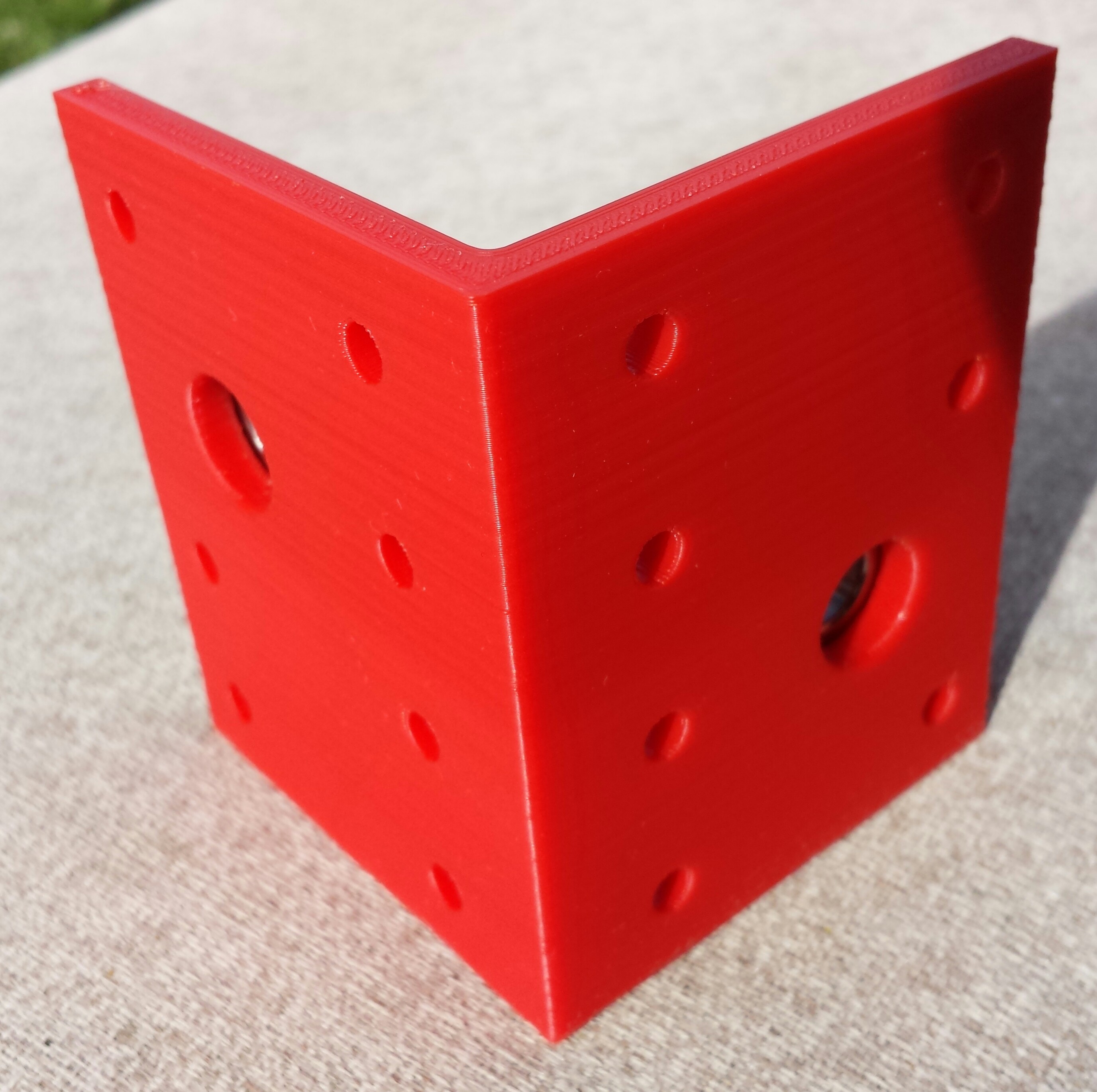

@Shauki Thanks. I am still fighting z-ribbing. I have to order a lower tooth count for my z stepper motor that results in integer steps to avoid the rounding errors. I noticed Jason does not have this z-ribbing issue on his. He is using a 20 tooth I believe.
But I am SUPER pleased with my x&y tolerances. This was printed at around 100mm/s. The only defect I find is around 100mm/s it begins to introduce very mild ringing around sharp corners that shows on vertical faces. But in simplify3D I can minimize this by turning down my exterior perimeter modifier but let the other perimeters fly.
I just checked. I had dropped max acceleration to 7000 mm/s2 when I started it up until the bushings smoothed out as I had chatter at 9000. Yes I have default at 4000mm/s2.
