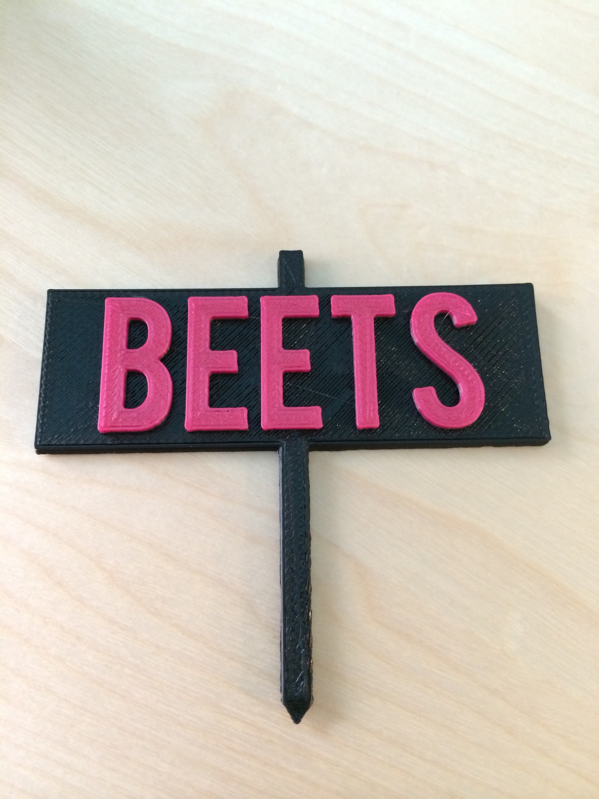

First successful print with two colors by pausing and switching halfway through.
Interesting. Is the 2nd color sticking well to the first ?
So far. I only took about 15 sec to switch between so they were still warm.
