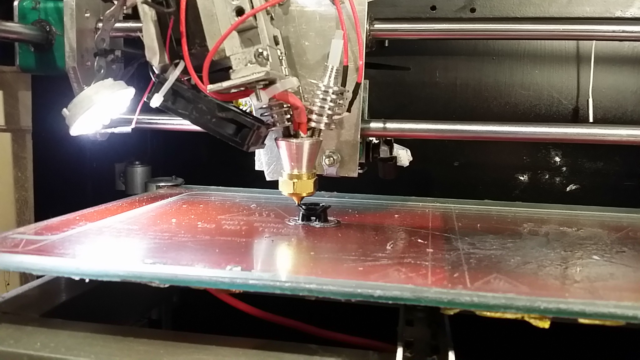

First test of my new Diy hotend. Two colors and interchangeable nozzle.
2 extruders ,one nozzle .
Interesting, it looks a bit like the Diamond hot end that I vaguely remember but haven’t heard anything about in quite a while now.
@Stephen_Baird that’s what I was about to say… Tho’ the inspiration is there kudos for the build!
Have you tested it with rapid retracts? I built a similar hotend sometime back and gaveup on it because it tended to jam on rapid retracts
@ekaggrat_singh_kalsi Has only tested that filament flows from both extruders .I need to make the second extruder drive today before I can test some more.
