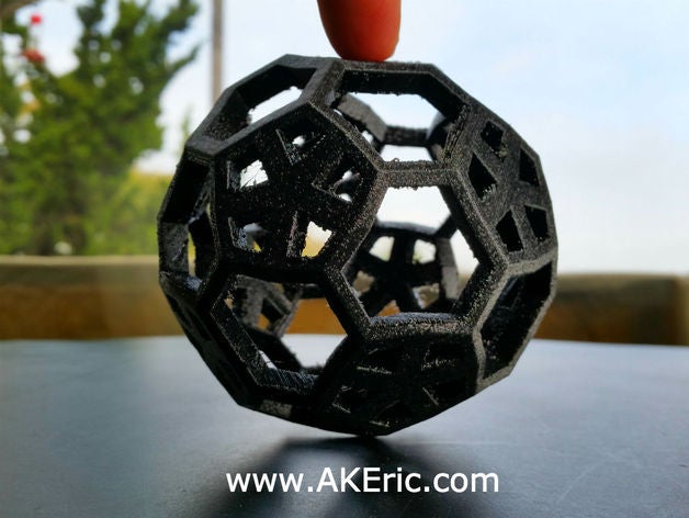

First time ever printing with Ninjaflex:
First time ever printing with Ninjaflex: Made this “test mesh” to see how it would work out: Surprisingly well for my first shot. Once thing I noticed is that it seems to behave a lot like nylon: I’ll need to add in more retraction for future prints to get rid of all the stringing. Any other Ninjaflex tips?
I’ve heard that 0.5-1.0mm retraction works with flexibles.
I started printing ninjaflex this weekend. Slow, slow, and slower was the key for me. I set the print speed at 15 mm/s and had good results. @Thomas_Sanladerer ​ has a pretty good list of tips on his youtube channel.
