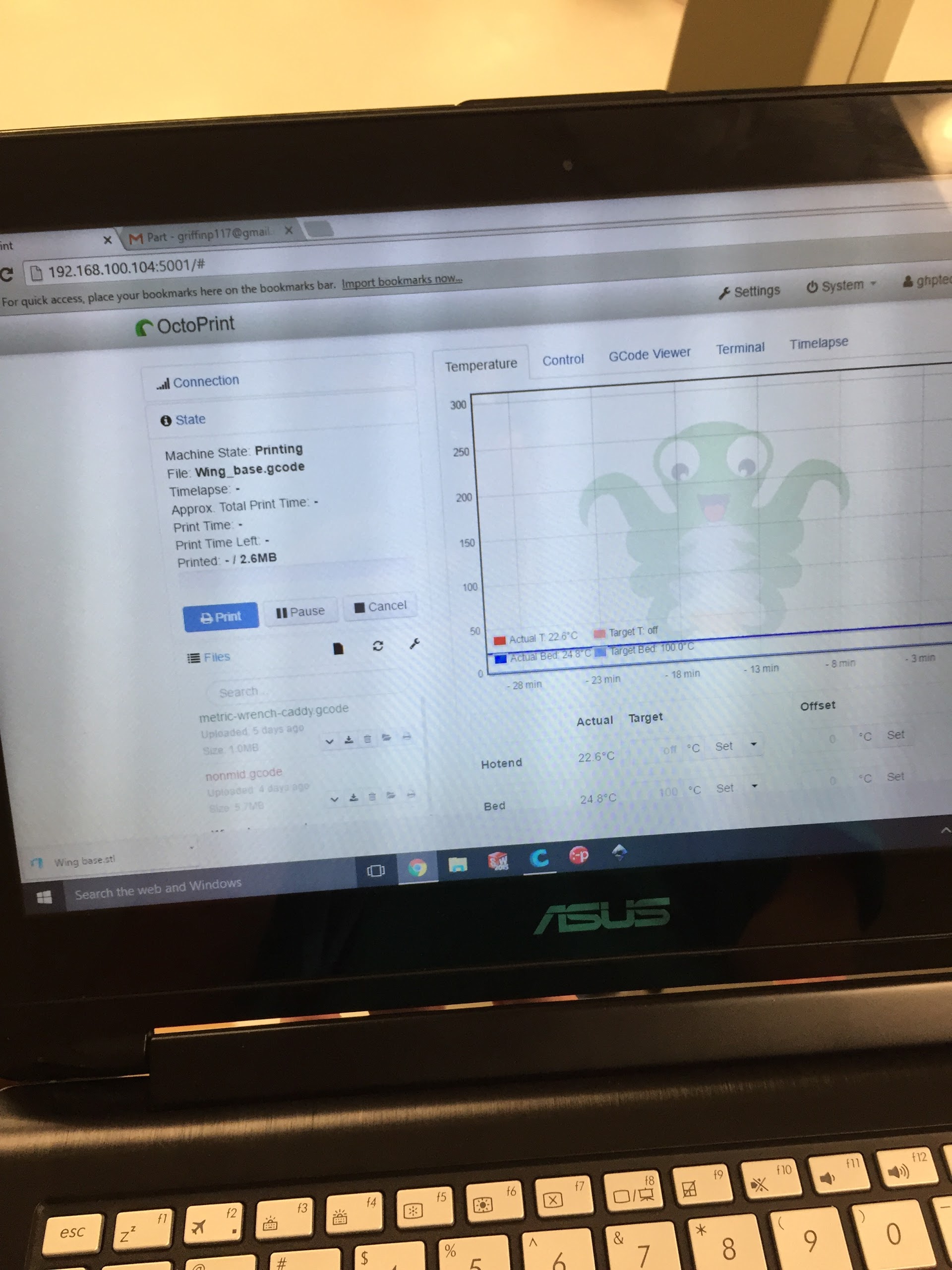

First time using octoprint today. Have to say I'm rather impressed.
First time using octoprint today. Have to say I’m rather impressed. It was so easy to do. My only concern about adding it to my personal machines is the price as Pi’s are not super cheap.
