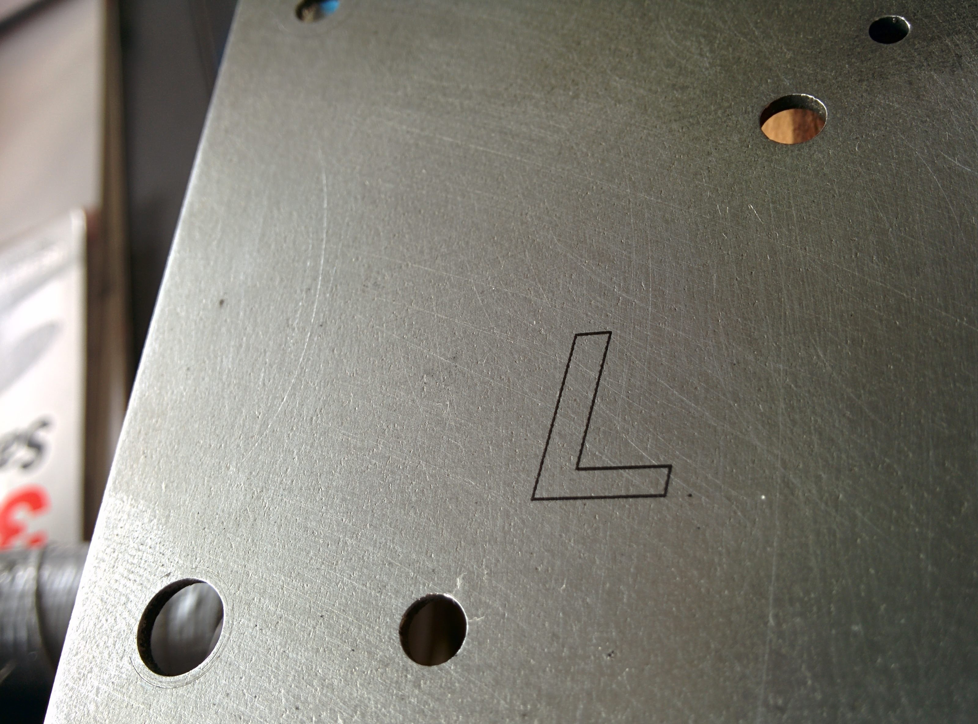

First try at laser marking steel
First try at laser marking steel. I sanded the surface to provide a tooth and sprayed on some dry moly lube. 40w CO2 at 90% 400mm a minute. Then sprayed the part with wd40 and scrubbed off the moly lube with a scotchbrite pad.

I did a bit of research about marking metal. I don’t have a link ready, but, the idea was a grid of percentages. One axis was speed incremented in 10 percent steps and the other axis was power. When finished you could see a cluster of blocks that were acceptable. I wonder if it changes by material and/or thickness.
Materials fo have some affect on you marking capability, but the refractive properties have a larger affect. Why the moly coating? Were you concerned about the scattering of reflected radiation or were you thinking it would act as some sort of fire retardant?
I read somewhere that the ingredient in the moly lube was very similar to cermark. So I had some on hand and thought why not try it out.
I too have read that dry moly lube is similar to cermark. $16 vs $73 means hackers/makers have to try. :slight_smile:

Nice result. I’ve got a can sitting in the shop, just haven’t gotten a chance to test. I’m motivated again.
