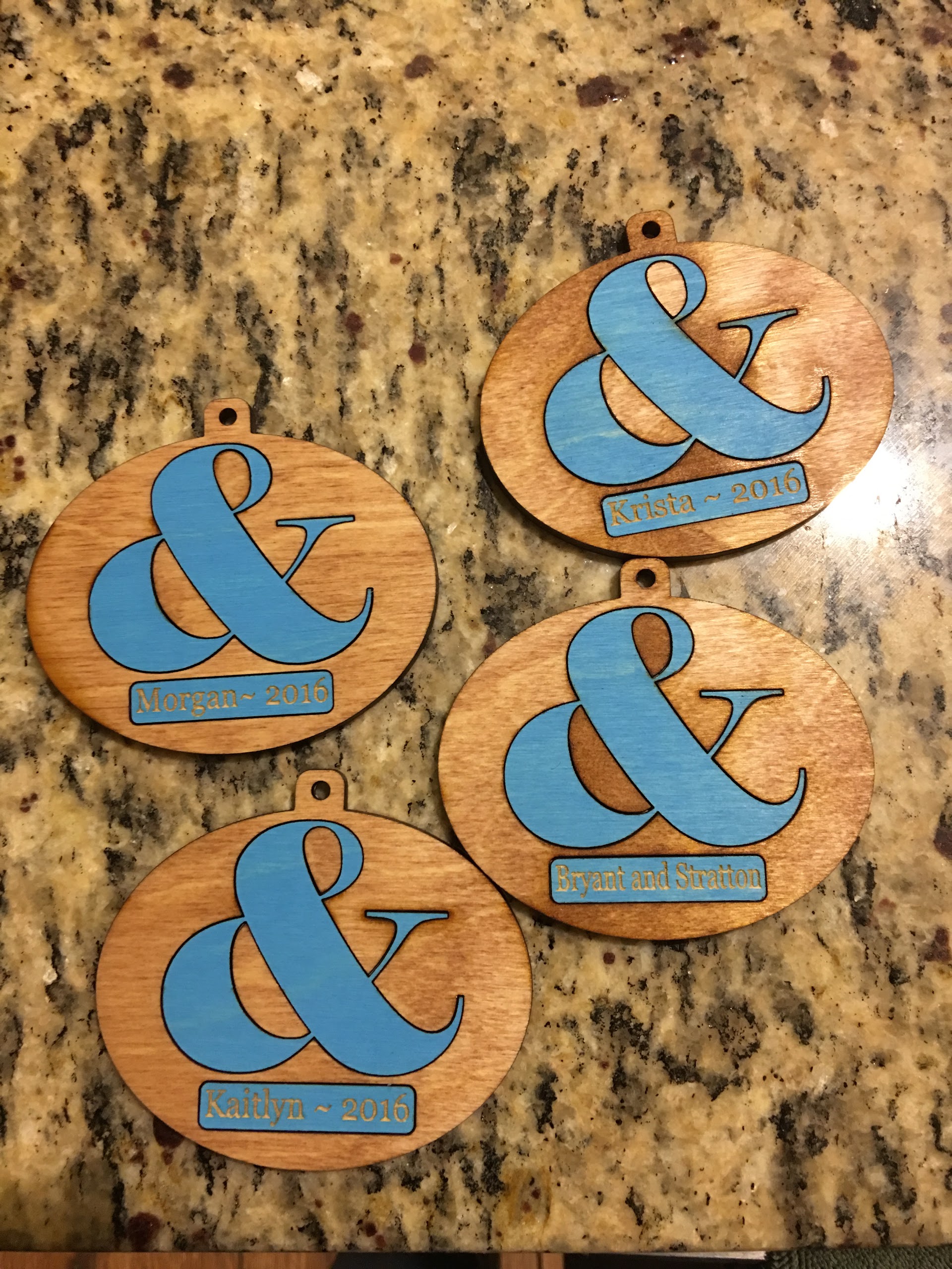

First try at making custom Christmas ornaments tell me what you think
Those are great. Ive thought of a similar type of thing but have no discernible painting skills.
Mask the wood with painters tape, lightly (or more) etch the parts you want painted, spray them blue when they’re done. Remove painters tape.
The blue is actually an inlay so I stained an entire sheet masked it and cut out all the shapes then glued them in place
Nice inlay work. Looks like you’re spot on with your kerf adjustment.
@Jim_Hatch honestly I didn’t adjust anything. up close you can see the spaces but for what it is they turned out nice
Nice. I see you’ve worked out your masking/painting issues a bit better
