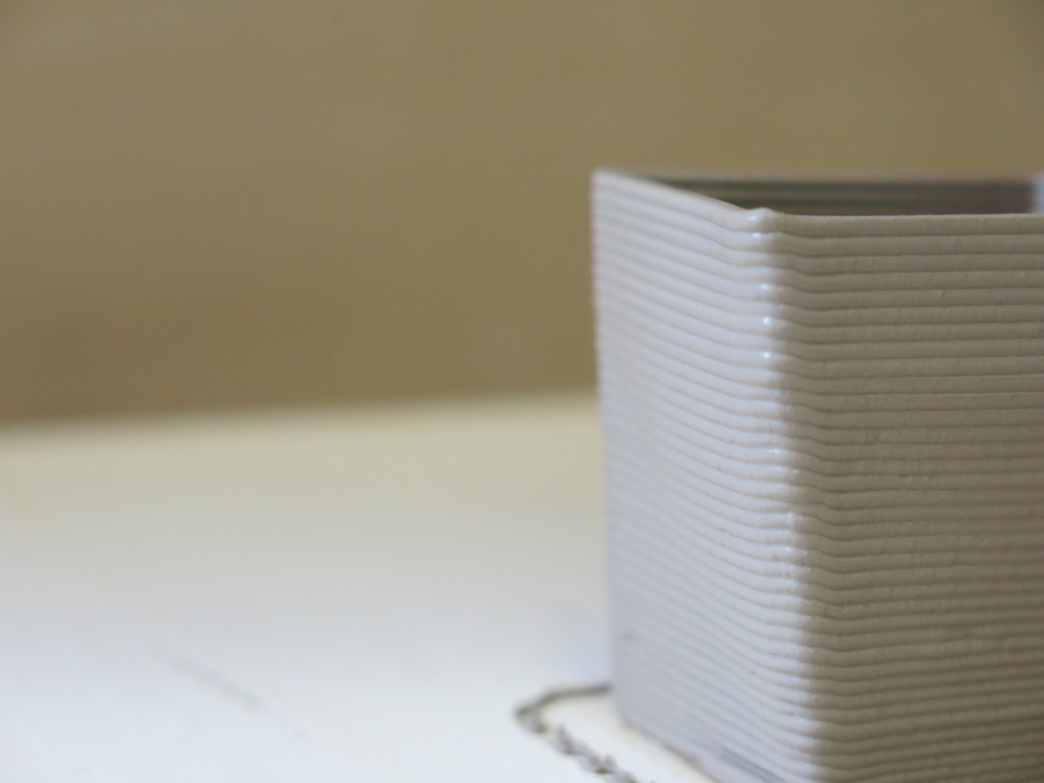

first try ceramic printing on new design and build piston  http://playground84.com/pastestruder-syringepump/ more to come..
more to come…

@Dominic_Amae hi thx, the idea about this setup is to have a really easy to swap system( it’s actually take me less than 5mins to switch from plastic to ceramic - 1min switchin hardware 4mins software [ estep/mm / zMin] )
BUT the problem i’m facing now is the bowden add a LOT resistance … so the paste have to be more “wet” witch make HIGH print really hard to do, i’m trying a redesign to make the tubing bigger to reduce the resistance a bit… i’ll post result as soon as i 've some . i’ll have to find out the GOOD mix for the ceramic paste too
@J_DTRTR if you want to reduce resistance, try decreasing the length of the needle - that’s the point of greatest constriction, so I expect you would see flow improvement with a much shorter needle.
@Dominic_Amae good to know i’ll try , the ting is the connector ( syringe/tubing ) add lot’s of small constriction . but still i’ll try reducing the needle lenght
