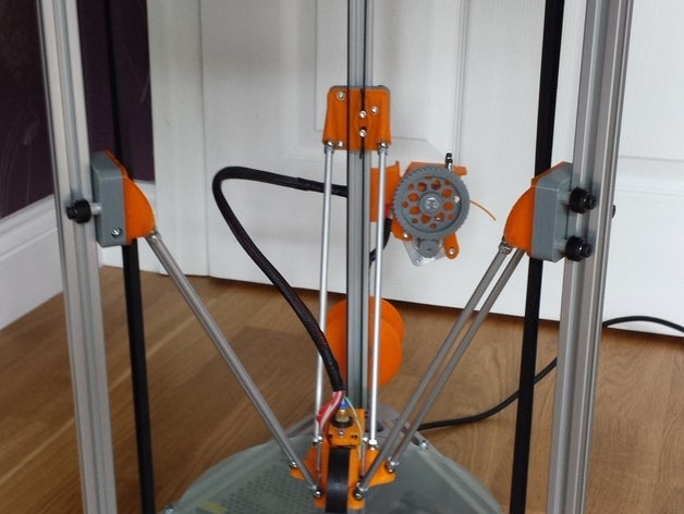

I hope your experiences with your Delta are better than mine. I could never fully remove the drag of the u-joints, which caused all kinds of problems.
The biggest problem we are having is simple lack of experiance.
The effector/carriages are based on this:
The later model, with balls-on-stick and held together with springs. It’s very solid and the only downside is if you ‘over extend’ it tends to self-destruct. :slight_smile:
Right now the parts are ABS, but once we are happy(There’s some changes to be made), the final ‘socket’ parts will be all Delrin.
