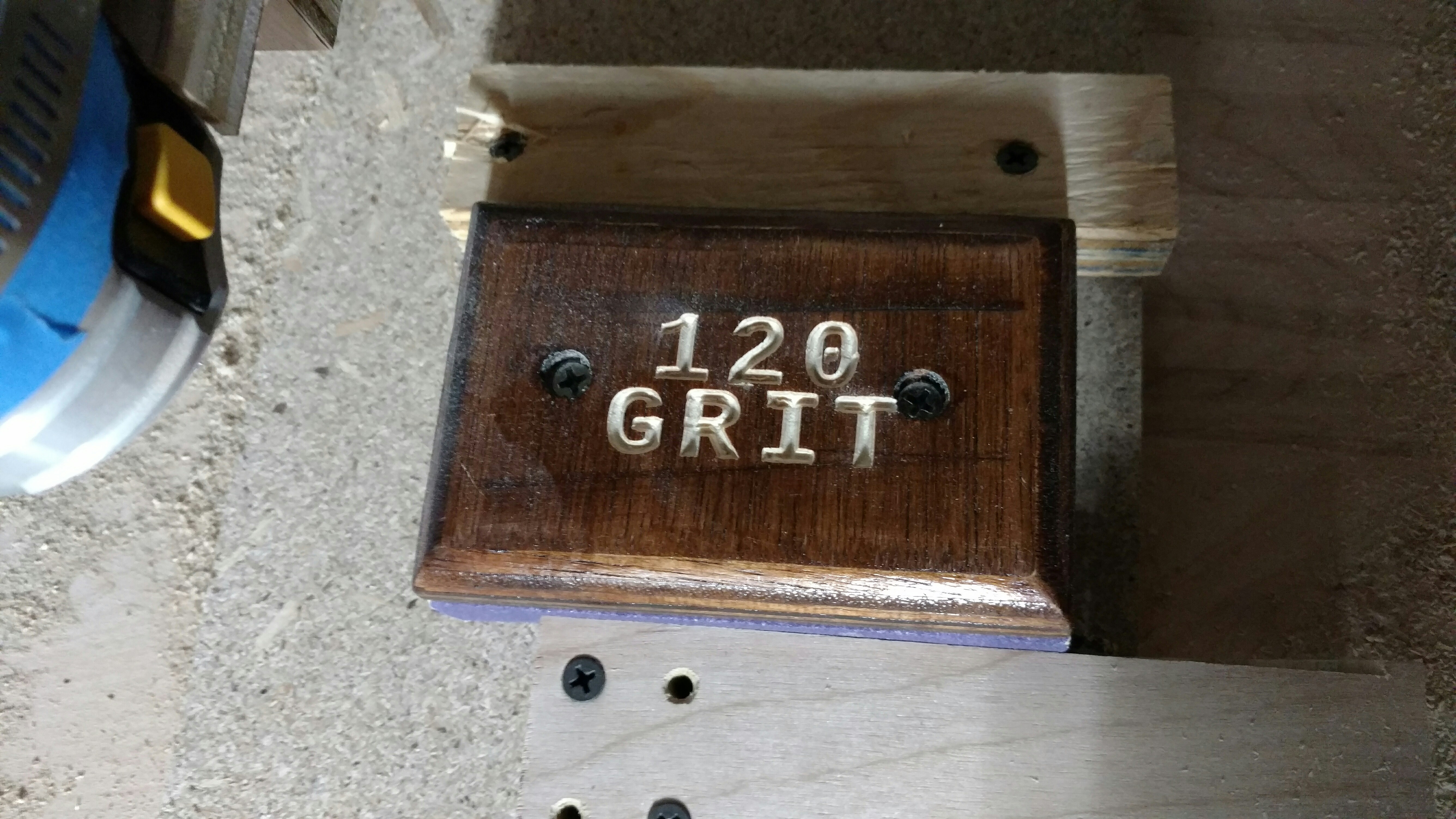

First useful cut… A little off centered, but still pretty!

It looks great. I wanted to do a bit of engraving for my shop today, but the G Code I made did not work right.
Congrats!
Set your G54 (workoffset) to the center of your parts and apply tape to draw crosshair on so not to mark the material when it matters.
