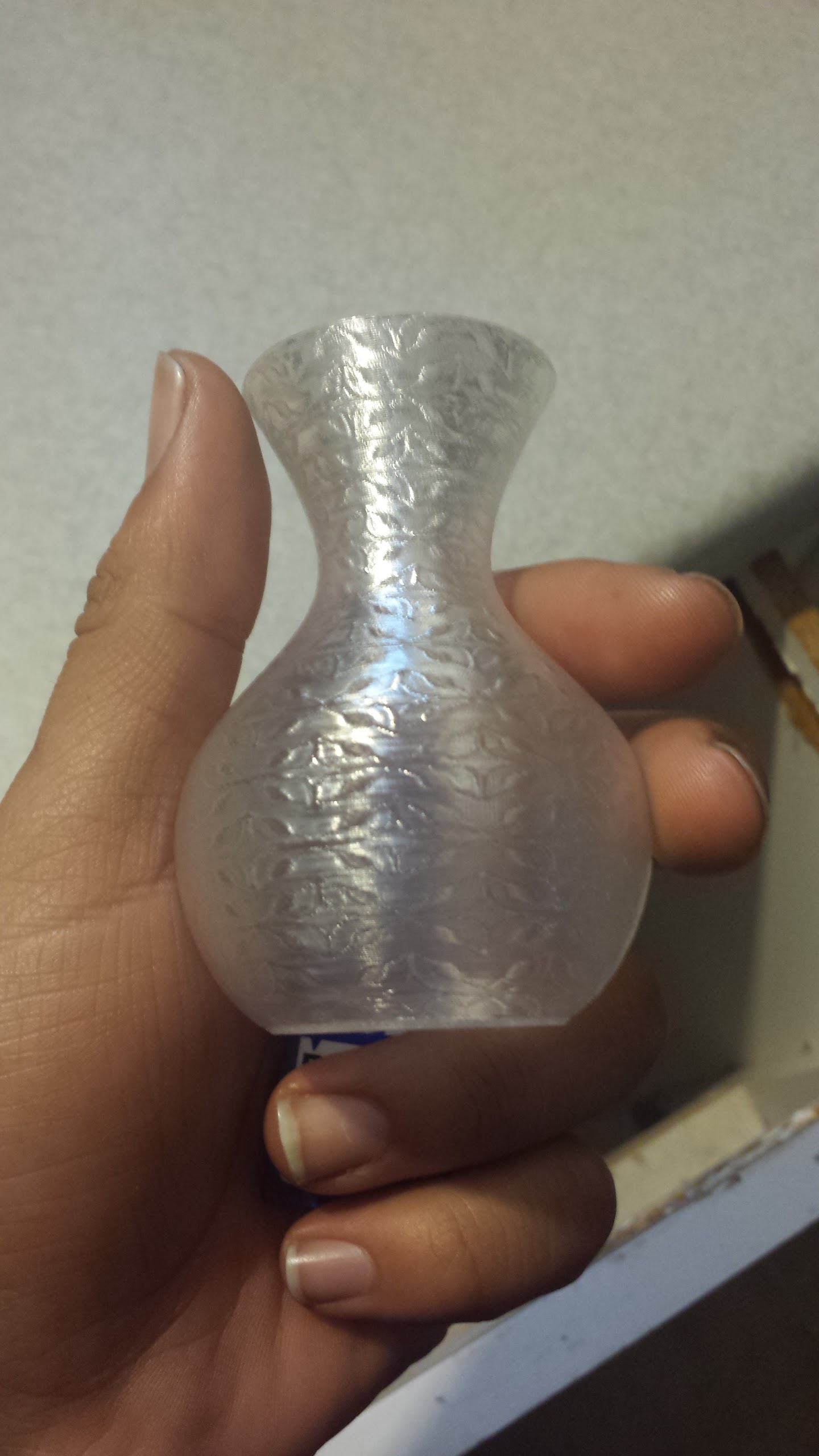

First velocity painted vase :)
First velocity painted vase :slight_smile:
Gorgeous!
a beauty for sure!
It looks like glass because its only 1 layer. Making a 2 layer one next. This one is slightly flexible but still too fragile
@Cristian_Martinez Try widening your perimeter width whilst keeping it still one perimeter? 0.4mm nozzle is good for something like 1mm when in vase mode, certainly for 0.6mm and the result is much stiffer.
Nah i wanna make these 200 to 400mm tall so 1 perimeter wont do me any good. Im upping them to 7 perimeters like the vase i made my mom for mothers day. Amazing light diffusion as well
