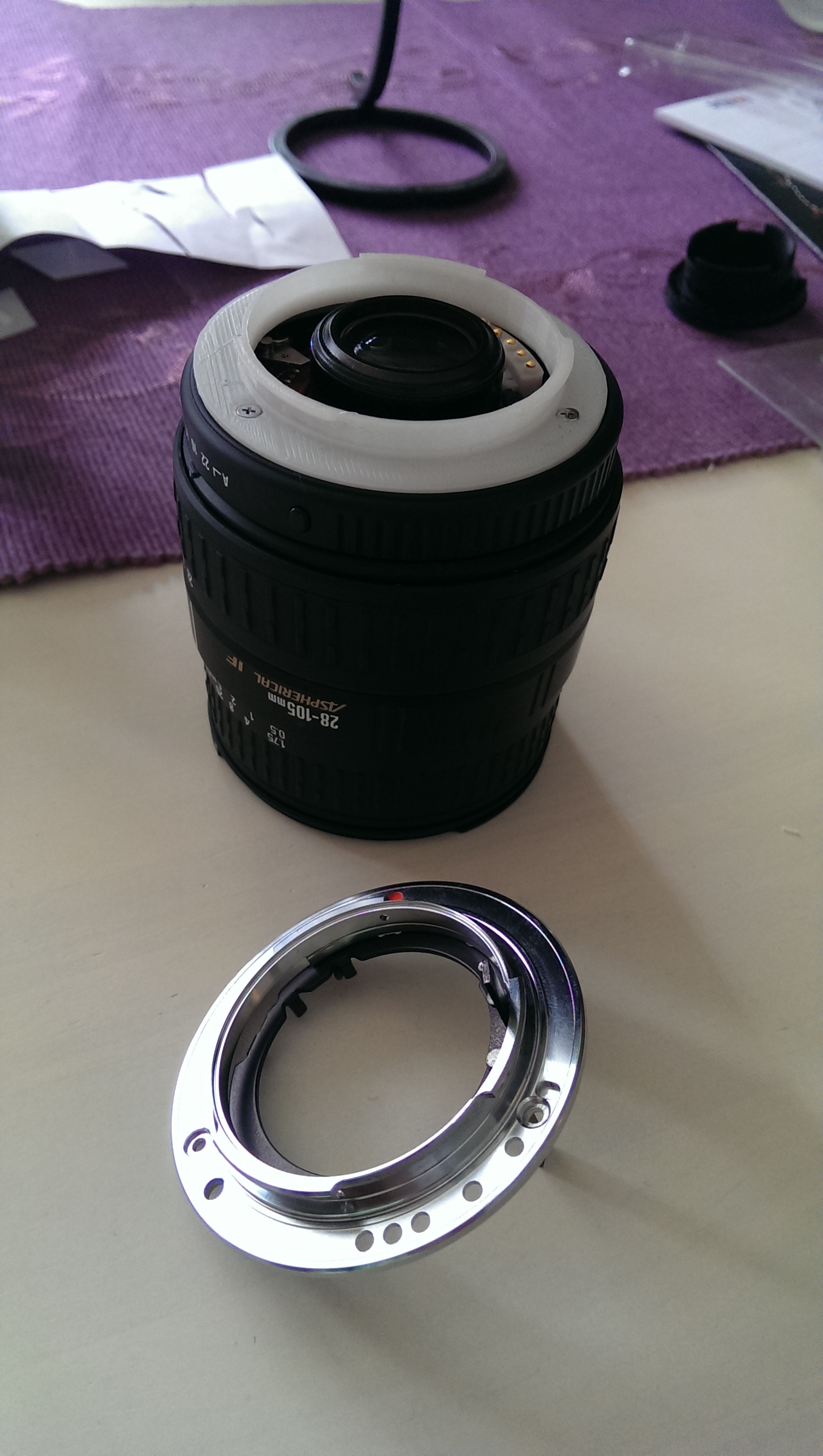

First version of my Pentax to Sony A mount. It works....
First version of my Pentax to Sony A mount. It works… No how to get the aperture ring to work.
I’ll just fix it so it will work in manual mode but would be cool to get it to work with Sony’s level arm.
Unlocking the market, nice.
Should not be to difficult to do on a CNC machine and a lathe. But the ABS is holding quite good even if the thinnest walls is 1.3mm thick.
