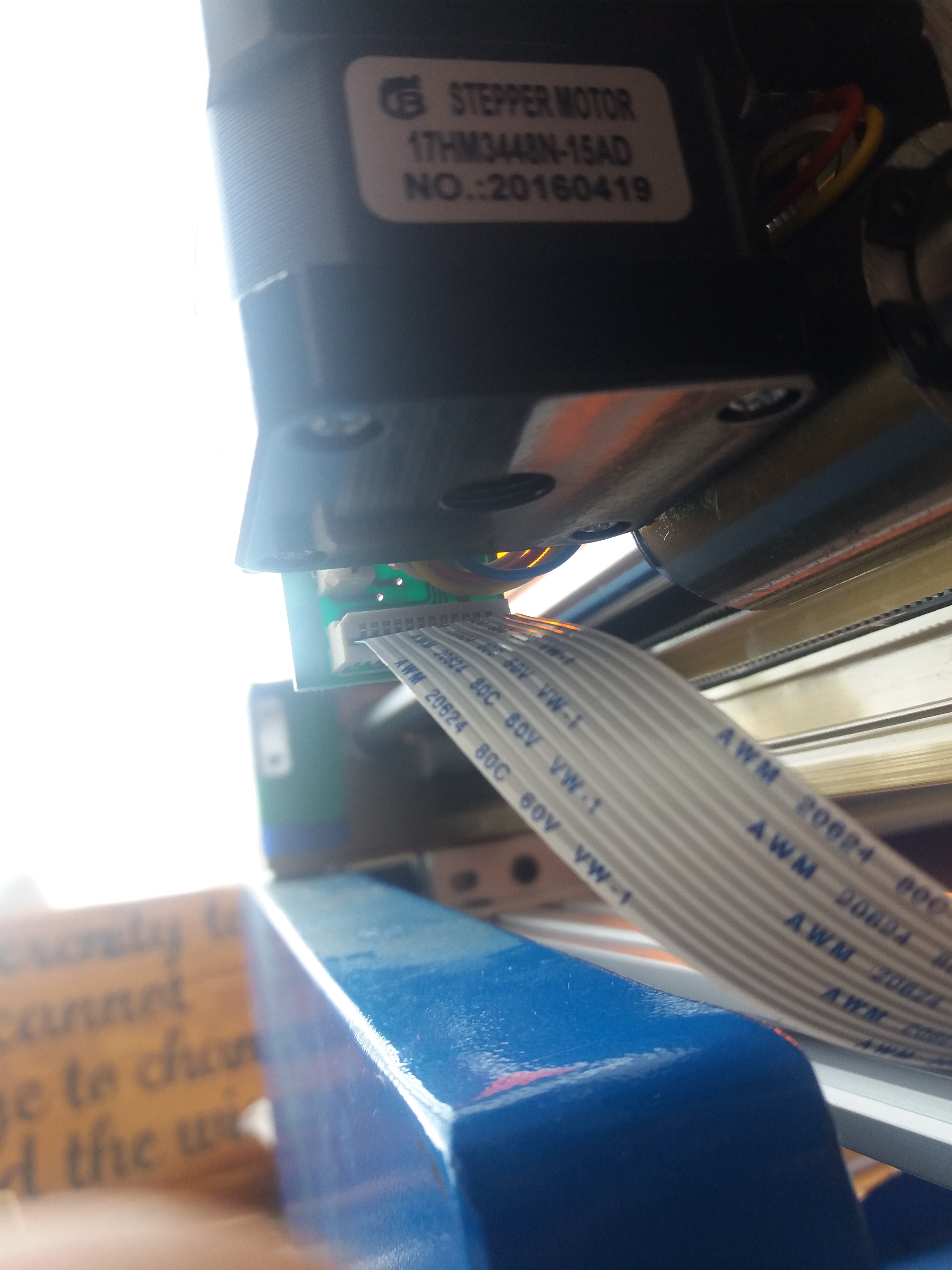

FIXED FIXED FIXED… hey guys need some help getting my machine working again. ive been searching around for ages to no avail. basically ive extended my bed used only original parts apart from adding the extra length on the x azis… everything was going fine and dandy till ive hooked the mechanics up and now it wont home properly and when i open a file in whisperer and move the image around, when i move left it goes right and visa versa… ups up and downs down when i move it around in whisperer… ive looked at my limit switches and they look ok but im no expert on limit switches,does the metal stripes that go in the switches break a beam or something? ive extended the bed in the whisperer softwarethe strip cable is in the correct way also. I’m at a loss now,please help lol…

@SirGeekALot i didnt dissemble the gantry at all other than disconnect cables and take of the x axis rail and replace with a longer one, oh and the dual stepper drive shaft (if thats what its called) if i single jog in using whisperer up it goes up, down/down. but if i single jog right it goes left, visa versa. The corner position arrows in whisperer work the same also, so from normal k40 home (top left) press top right corner it goes to the left on my laser head. if i then go bottom right its now in bottom left as it went left and not right in the second command and so fourth… i hope you get what i mean

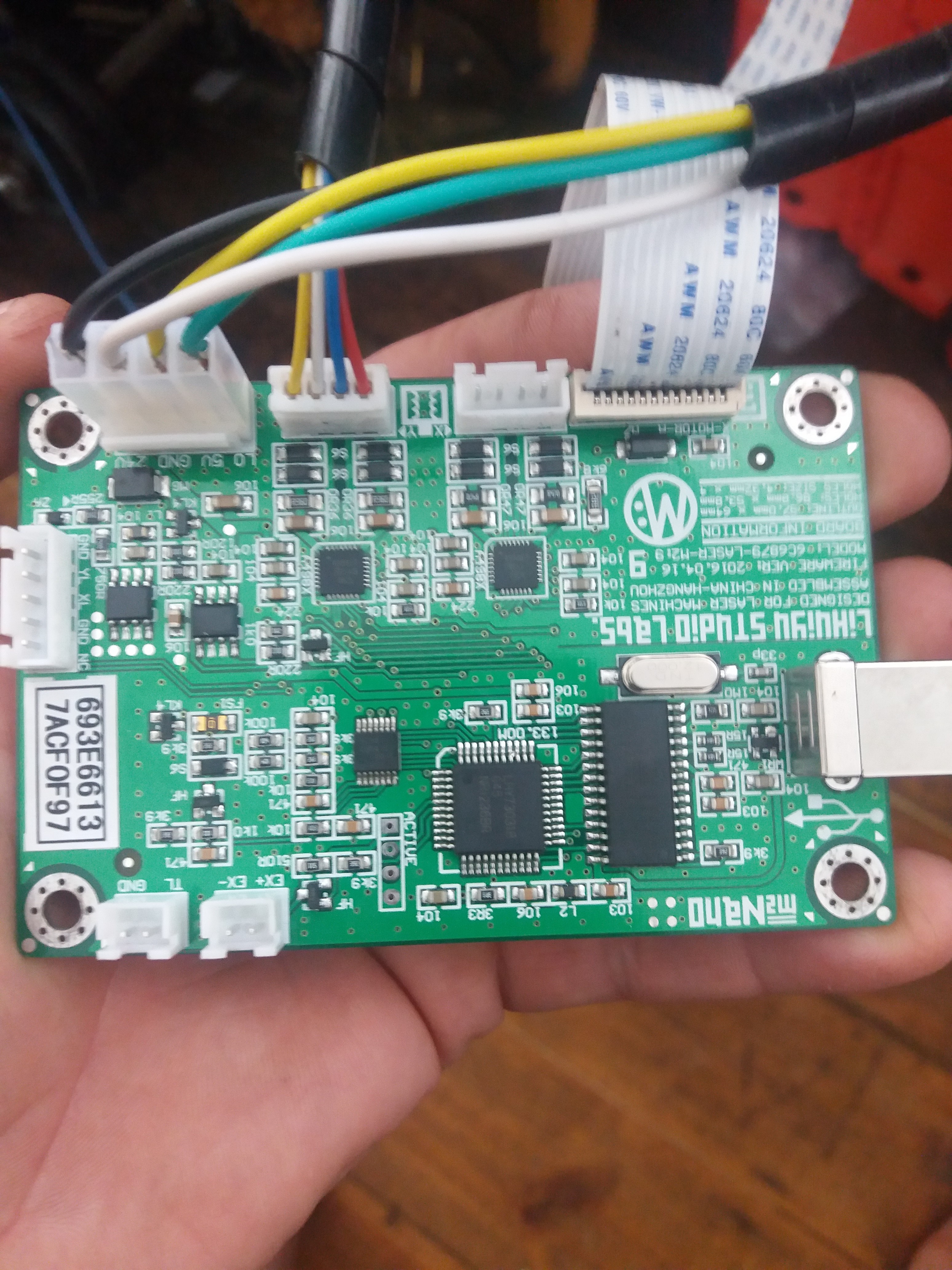

im going to install some mechanical endstops i was planing on doing them anyway at some point. do you happen to know the connector for the endstops and the x axis terminal block on the m2nano? past crimping connectors ive no real idea but trying to learn.

@James_poulton no, I don’t know what the connector names/part numbers are.
this one i took out the flat cable of the y axis and put the x axis in the y, get me… ?
The end stops are wired through the ribbon cable.
the connectors are JST-XH 4 & 5 pin.
Im going to take the ribbon out put a stepper motor cable on, an connect the mech end stops to the board via the spare connector on the right of the board above where the 24v goes in…
