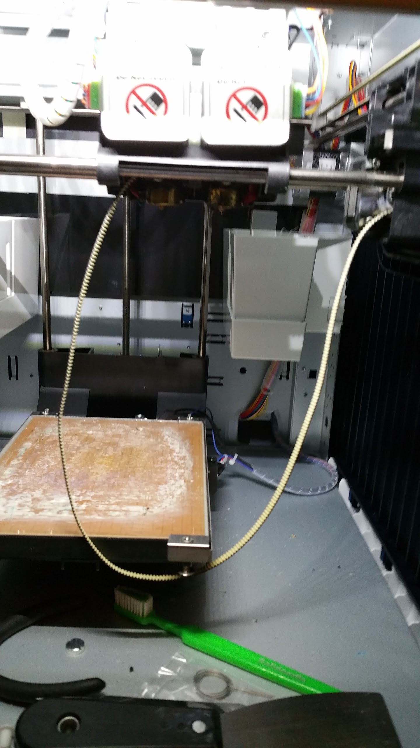

Fixed my Da Vinci with the tensioner out of Thingiverse ( http://www.thingiverse.com/thing:805215 ).
Fixed my Da Vinci with the tensioner out of Thingiverse (http://www.thingiverse.com/thing:805215). i ditched the spring and it’s been working for 2 hours straight so far. XYZPrinting said they will replace my tensioner even though I am 1 month out of warranty, so hat’s off to them for that (although they do not know when the part will reach me). Meanwhile, I am back in operation. You can see the before and after. I think one should have more than one printer…so that one printer makes parts for the other…
