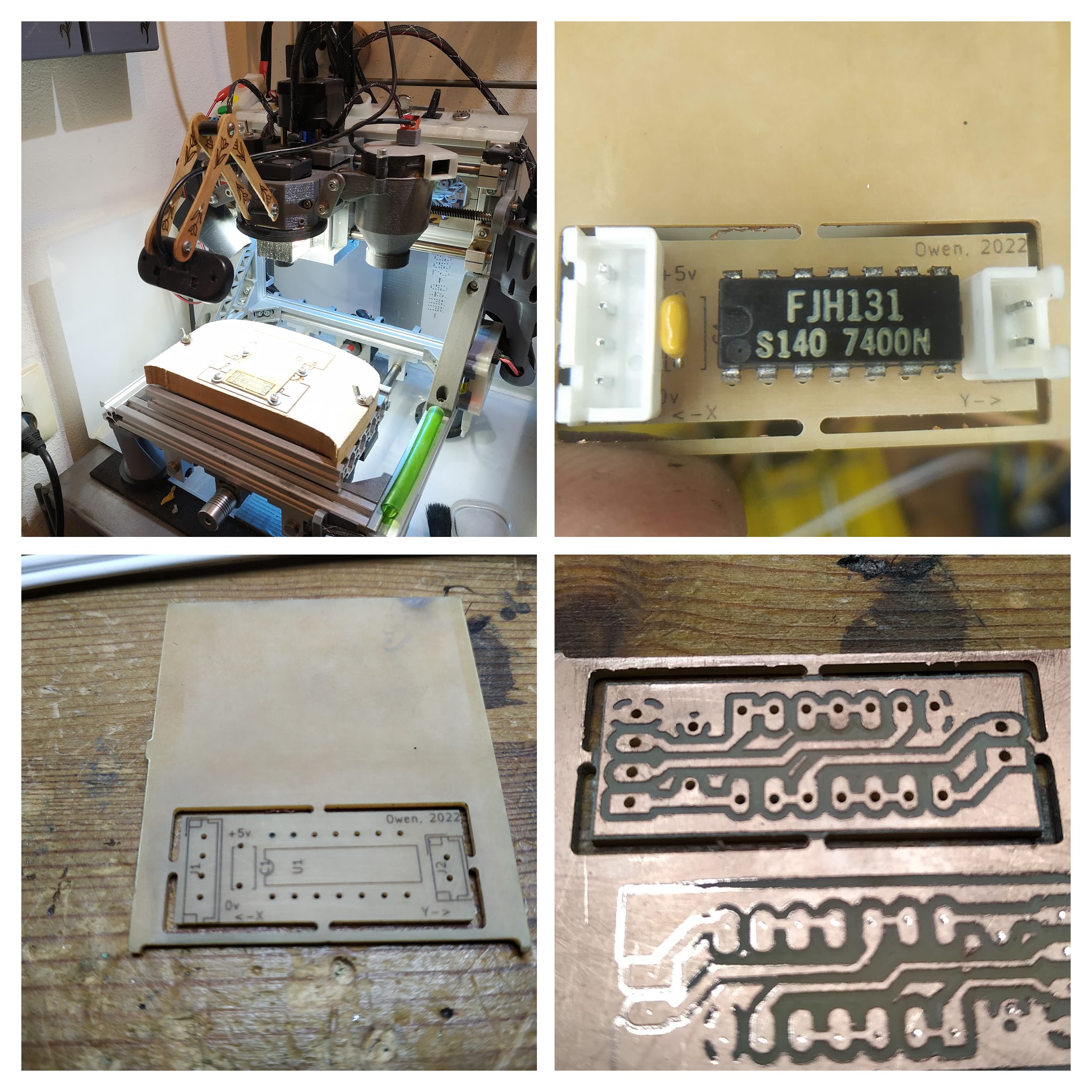

Okidoki, I used my baby CNC to do the cutting and marking; once I’d worked out a more level clamping system the board came out ok, and is actually quite nice and compact to handle.
All done with open source tools:
KiCAD for schematic and layout, flatcam tor CAM, LaserWeb to run the gcode and FluidNC for firmware… plus the CNC is an openbuilds design and my computer runs linux :tada:
(Being able to do this kind of stuff on a fully open toolchain is important to me)
I use some standoff/adapters on the StepSticks to break out power and the signal pins without needing to modify either them, or the motherboard. Aligning and wiring this up was the fiddliest job of all…

As a side note; I do the markings on the PCB by applying a thin smear of carbon black powder then making a fast pass with a 5w diode laser, after cleaning the results are great.
