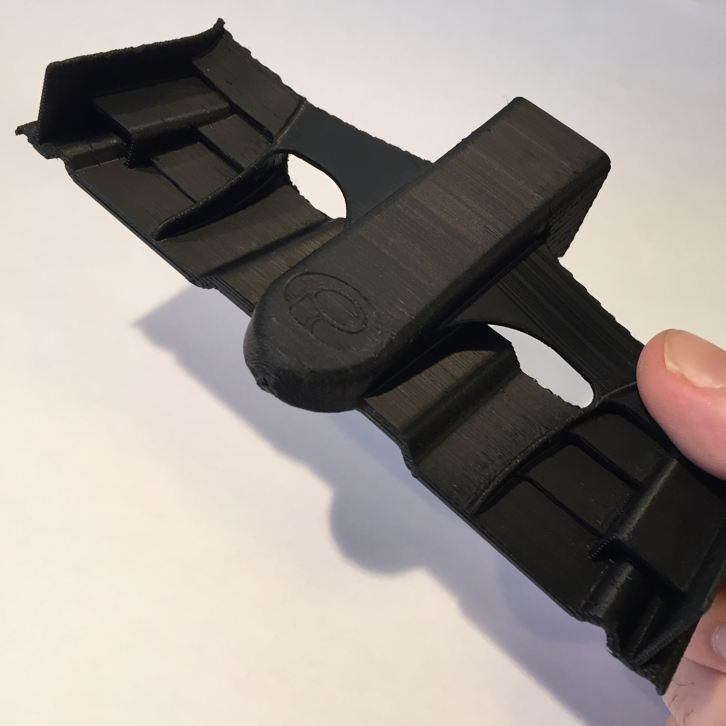

Flexible TPU print easy support removal… (http://www.thingiverse.com/thing:1884110)
How did you get the supports to break with TPU? Is this your magic 95a material? I’d like to see your slicer settings
@Austin_David no magic needed
Yes its the ETPU 95-250 Carbon Black. I use 0,3mm horizontal offset for the support.

@PAULE_VALENTINE it will act as a crash-safe bumper on the OpenRC F1 car, bending/absorbing when crashing the car into something
