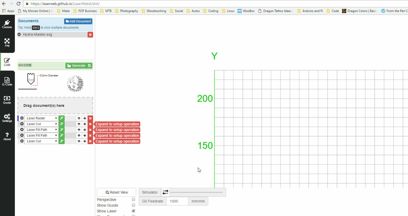

Oh, so I noticed that my red tags aren’t going away even after populating each operation but the gcode seems to generate.
Those are a reminder that you need to setup something there
But there was nothing left to setup. I filled in all of the required fields. For some reason they didn’t go away though.
@Carl_Fisher I agree with you and was detain the same. Haven’t said anything since I beleive it’s a good indicator for now and news users
This shouldn’t happen. I just added some logging info. Look for entries like the following next time it happens:
Laser Cut field “passes” failed check
No change. I just tried and added a single path, filled out all of the fields, including setting a fill and stroke filter just to test and the only thing I get is “Expand to setup operation”. I don’t see any more verbose error than that.
Seems to do it on the laser cut. It wasn’t showing up on the raster. I’ll have to check the other operations.
Found it. Laser Cut field “aAxisStepsPerTurn” failed check
Looks like it’s trying to validate the a-axis boxes even when a-axis is not selected.
fixed.
